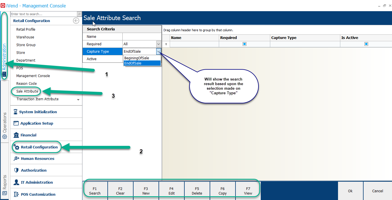

Path to open the setup screen: Administration > Retail Configuration > Sale Attribute
Figure 1 Sale Attribute Search

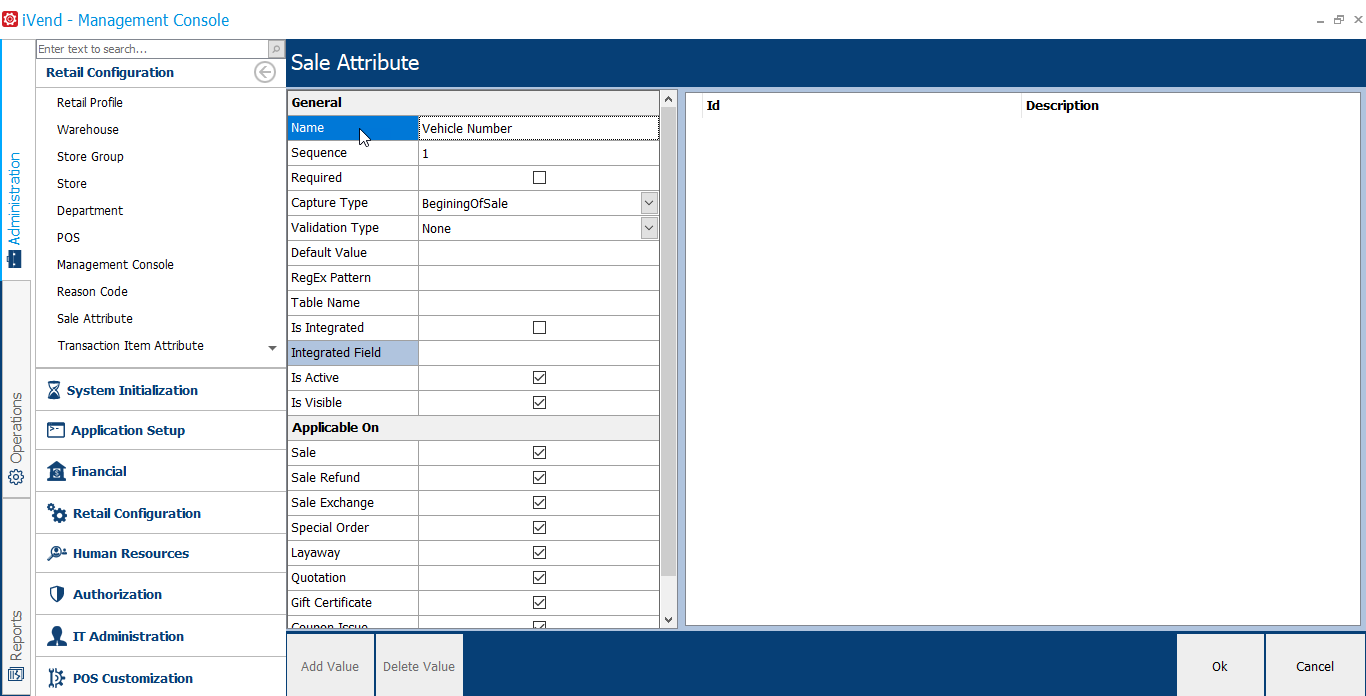

To create a new Sales Attribute, click on the [F3 New] button, which will open the Sale Attribute setup screen as shown in the image below. Enter the details as per the business requirement.
Figure 2 Sale Attribute
The following table explains the field details on the Sale Attributes setup screen:
Setup Screen
Field
Description
Name
Enter a unique name for the Sale Attribute.
Sequence
Enter the sequence in which the attribute needs to be displayed and prompted on the Sales Attribute screen at the POS. More than one screen can be set up to collect information.
Required
Use this option, if the user at the POS is required to enter the value in the attribute screen to proceed further, i.e. It becomes mandatory for the cashier to enter a value.
Capture Type
Select one of the following:
Beginning of Sale – This will prompt for a value to be entered at the POS before the transaction begins.
End of Sale – This option will prompt for a value to be entered for the attribute once the user at the POS completes the transaction by pressing either of the Payments buttons – [F11 Quick Complete Cash] or [F12 Payments].
Validation Type
Select a Validation Type from the following:
None: No validation is applied by the system on the values entered by the user. This is the system default.
Table: The list of options for the field will be shown from a table defined in the Table Name field.
Valid Values: The user can define a list of valid values by clicking on the Details button. These valid values will then be shown to the POS user while performing the transaction at the POS.
Customer: The user can define a list of Customers and these will then be shown to the POS user while performing the transaction at the POS.
Product: The user can define a list of products from the available products in the system and these will be shown to the POS user while performing the transaction at the POS.
Note: The Validation Type has to be decided at the time of creating the Sale Attribute – Once the attribute has been saved to the system it cannot be changed.
Default Value
Enter a default value for the attribute, which will be displayed at the POS. The user can then change the value at the POS if needed.
RegEx Pattern
Enter a Regular Expression Pattern, which is to be used for validating the data input by the POS user.
Table Name
Enter the Table Name from where the values are to be shown in a list format to the user at the POS – this is required if the Validation Type is selected as “Table”.
Is Integrated
Mark this flag if the captured information is to be integrated to an ERP such as SAP Business One.
Integrated Field Name
Enter the name of the User Defined Field (UDF) to which the Sale Attribute information is to be integrated to in the ERP.
Is Active
Select this option if the Sale Attribute is active.
Is Visible
Select this option if the Sale Attribute is to be visible to the user at the POS.
Checkbox
Select the transaction types for which the Sale Attribute is to be captured – the options are:
· Sale
· Sale Refund
· Sale Exchange
· Special Order
· Layaway
· Quotation
· Gift Certificate
· Coupon Issue
· Delivery
By default all are selected, therefore the user needs to deselect the flag for the transactions where the information is not required to be captured.
To save the changes made to the Sales Attribute setup, click on the [Ok] button.

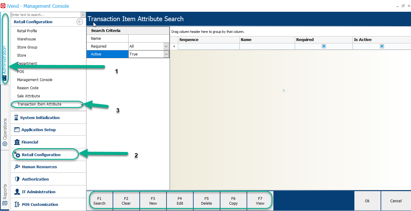

Path to open the Transaction Item Attribute setup screen: Administration > Retail Configuration > Transaction Item Attribute.
Figure 4 Transaction Item Attribute Search
To create a new Product Item Attribute, click on the [F3 New] button.

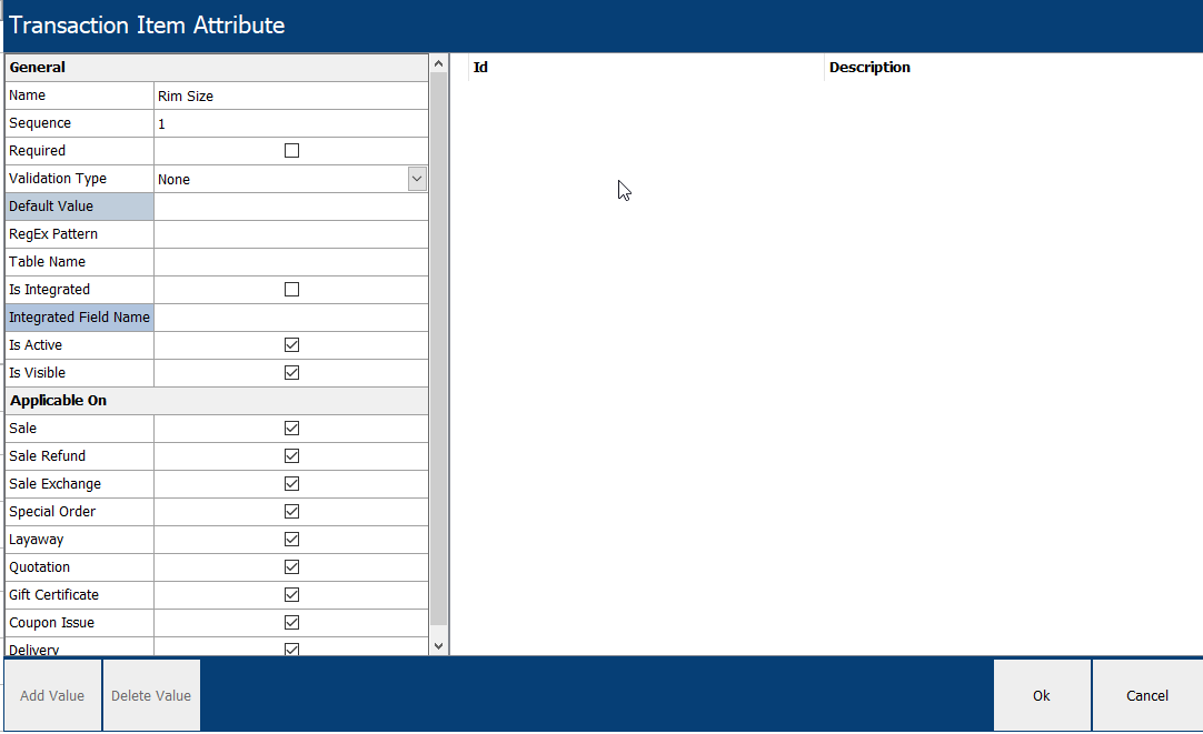

This will open the Transaction Item Attribute window that we see in the image below. Here the user can enter the details required to meet their business processes.
Figure 5 Transaction Item Attribute
The table below provides a detailed explanation of the fields in the Transaction Item Attribute setup screen:
Setup Screen
Field
Description
Name
Enter a unique name of the Transaction Item Attribute.
Sequence
Enter the sequence in which the attribute needs to be displayed and prompted on the Item Attribute Collection window at the POS. More than one screen can be set up to collect information.
Required
Select this option if it will be mandatory to enter the value in the attribute screen to proceed further.
Validation Type
Default Value
Enter the default value for the attribute that would be displayed at the POS.
RegEx Pattern
Enter the Regular Expression Pattern, which is to be used for validating the data input by the POS user.
Table Name
Is Integrated
Enter the name of the User Defined Field (UDF) to which the Transaction Item Attribute information is to be integrated to in the ERP.
Is Active
Select this option if the Transaction Item Attribute is active.
Is Visible
Select this option if the Transaction Item Attribute is to be visible to the user at the POS.
Checkbox
Select the transaction types for which the Transaction Item Attribute is to be captured – the options are:
· Sale
· Sale Refund
· Sale Exchange
· Special Order
· Layaway
· Quotation
· Gift Certificate
· Coupon Issue
· Delivery
To save the changes made in the setup of the Transaction Item Attribute, click on the [Ok] button.

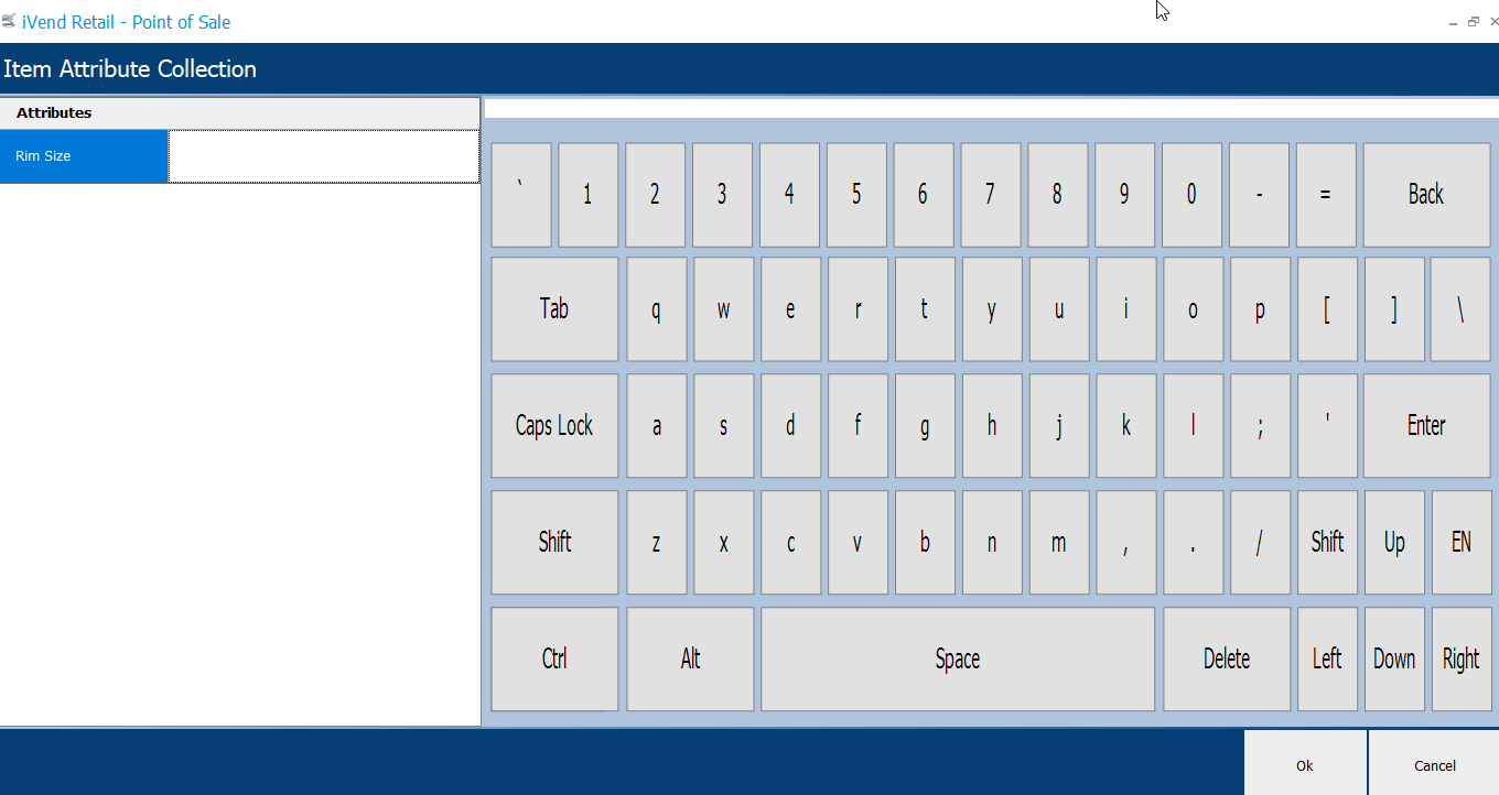

Applying the Transaction Item Attribute at the POS
At the POS, the user will first select the customer and then scan in the product(s) to be sold.
There are two mechanisms for capturing the Transaction Item Attribute:
· If the Required setting for the attribute is checked (enabled): On adding the products to the transaction at the POS, the Item Attribute Collection screen will automatically open and the POS user will need to enter a value before proceeding further with processing the transaction.
· If the Required setting for the attribute is not checked (disabled): The POS user can then access the Item Attribute Collection window for the line item selected via the [F5 Item Edit] button – there the will find a [Collect Attributes] button on the Item Edit screen where they can select it and enter the value required as a manual optional process.
