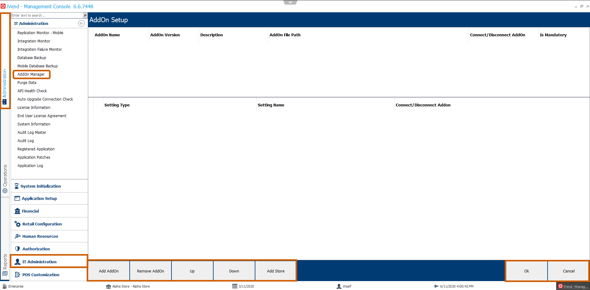

2. Go to Administration > IT Administration > AddOn Manager – the AddOn Setup screen comes up.
                                                                                                       Figure 1 – AddOn Setup Screen

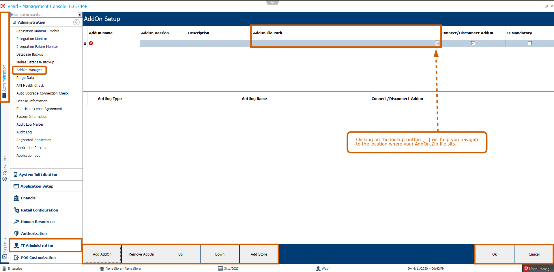

3. In the AddOn Setup screen, click the [Add AddOn] button.
Figure 2 – AddOn Setup Screen

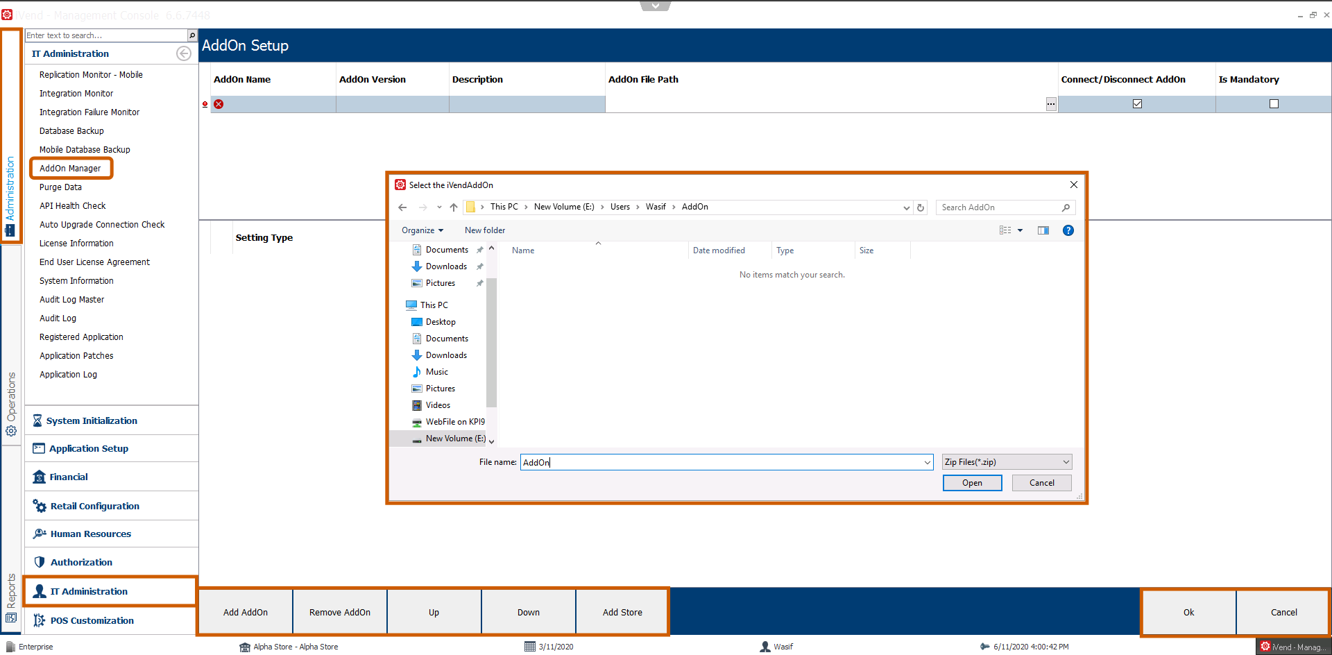

4. Select the Add-on file by clicking the lookup button in the AddOn File Path field.
Figure 3 – Target Location Search Window
3. Click the OK button.
