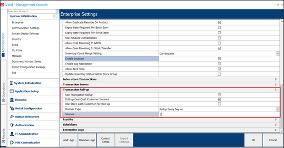

How to enable transaction roll-up in the Management Console
To setup Transaction Roll-up, follow this procedure:
· Login into the iVend Management Console and go to: Administration > System Initialization > Enterprise
Please remember this option is only available at the iVend Enterprise.
Figure 1 Transaction Roll up settings
Refer to the table below for detailed information on each Transaction Roll-up setting.
Setting
Description
Use Transaction Rollup
Select this check box to enable transaction rollup in iVend. One invoice per store/ per customer/ per business day will be posted in SBO.
Note: The user would be able to turn on this setting any time, even after the system is live. Once this setting is checked however, then the user would not be allowed to change it.
Rollup Only Cash Customer Invoices
If this setting is checked then only invoices, generated against the Store's Cash Customer, would be rolled up by iVend.
Use Store Cash Customer For Rollup
By default, the customer chosen in sale transactions at the POS will be the customer against which the rolled up transaction will be created in SBO, but if required then a single customer for each store can be configured as a Cash Customer and all the rolled up invoices will be created against each store’s cash customer.
Interval Type
Specify the processing of the job based on a daily basis or based on the hourly interval.
Interval
Specify the value in this text box based on the Interval Type chosen.

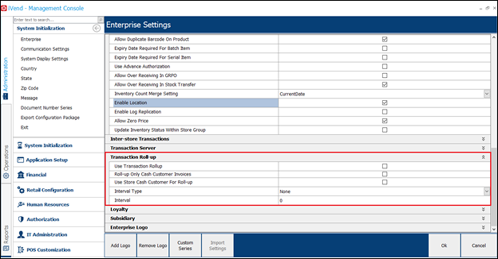

· Specify all the details in the Transaction Roll-up settings as per the above table.
Figure 2 Management console -Transaction Rollup
· Choose the [Ok] button to save the changes made for the Transaction Roll-up.
