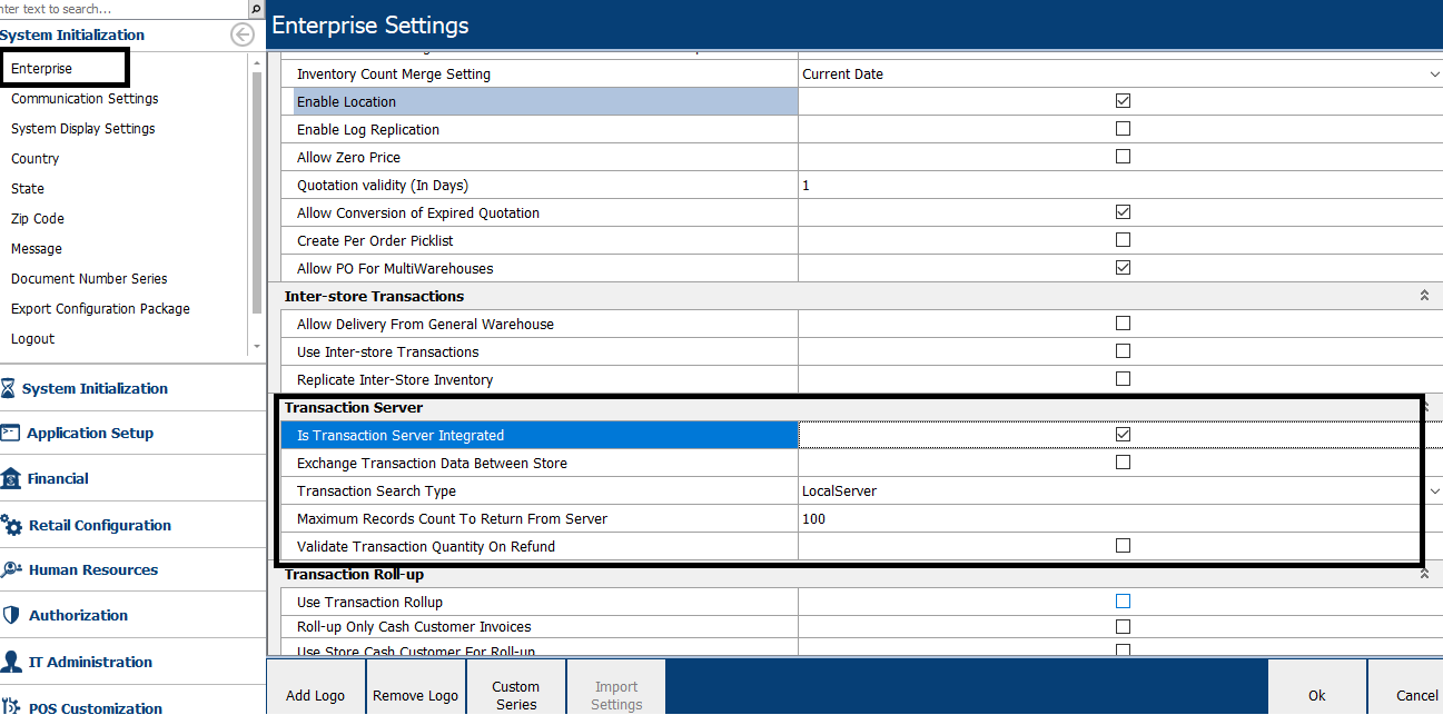

1. Log into the iVend Management Console and go to: Administration > Enterprise
Please note that this option is only available at the iVend Enterprise.
                                                             Figure 1 – Transaction Server Settings
Refer to the table below for detailed information on each Transaction Server settings:
Settings
Description
Is Transaction Server Integrated
Select this check box integrate the Transaction Server.
Exchange Transaction Data Between Store
Select this check box to exchange transaction data between stores.
Transaction Search Type
From the dropdown list, select the Transaction Search type option from either Local Server or Local and Enterprise Server.
Note: If you select the Local Server value from the drop down list, At the POS, both buttons [F1 Search] and [Transaction Server Search] will be available. The [F1 Search] button will fetch the data from local Store server and [Transaction Server Search] will fetch the data from the iVend Enterprise server.
Note:  If you select the Local and Enterprise Server value from the drop down list, then at the POS only the [F1 Search] button is available and this will fetch the data from both the local and Enterprise server.
Maximum Records Count To Return From Server
Specify the Maximum number of records count to be returned from the server when the search is performed.
Validate Transaction Quantity on Refund
Select this checkbox if you wish the quantity in the original transaction to be verified to ensure quantity being returned was valid.
1. Specify all the relevant details and options required for the Transaction Server settings.
1. Choose the [Ok] button to save the changes made to the settings in the Enterprise for Transaction Server.

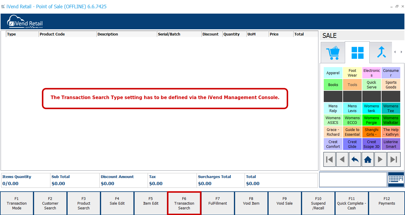

1. Log into the POS application, press [F6 Transaction Search].
Figure 2 – Transaction Search Screen

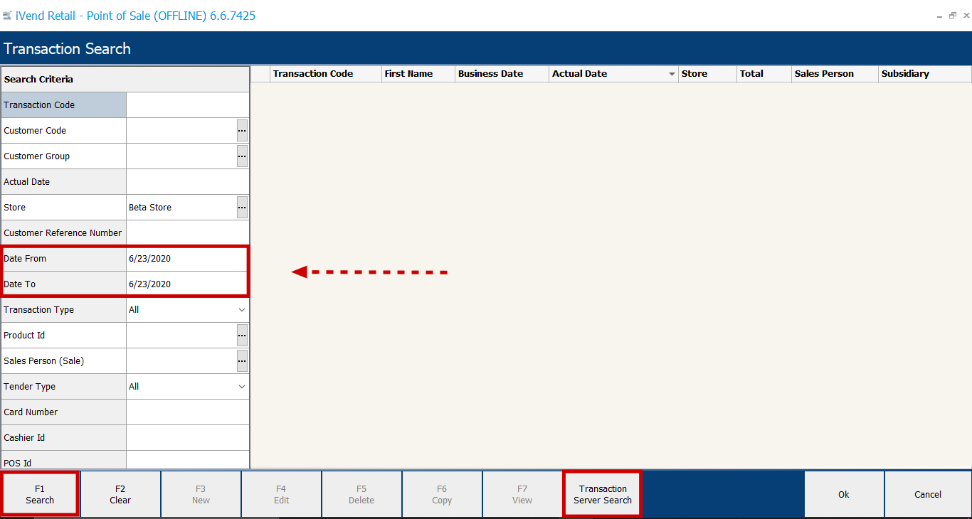

1. As in the example, the Transaction Search Type setting was defined as Local Server from the drop down list, therefore on the Transaction Search screen, both buttons [F1 Search] and [Transaction Server Search] will be available.
                                                                                              Figure 3 – Transaction Search
1. In our example, the Administrator has run a data purge for the store. Therefore, when the user runs a standard search using the [F1 Search] option, for a date before the data purge, the “No records found” message will appear to the user.

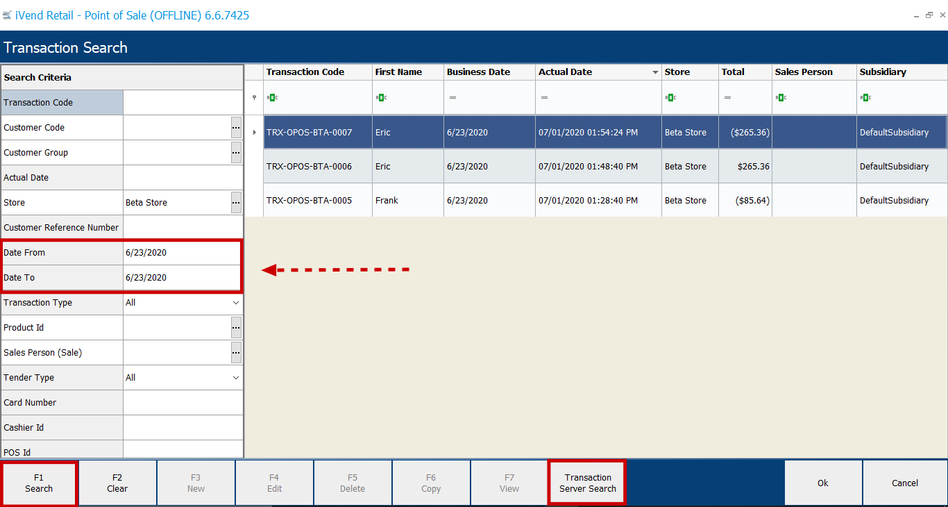

 1. If the user then runs a transaction search using the [Transaction Server Search] option instead for the same date that falls in the data purge range, then they will see data being returned.
                                                                                              Figure 5 – Transaction Search
 Note: If the data displayed in the Transaction Server Search screen is then used to perform an action such as a refund, then the data will be saved in the local Store server database.
