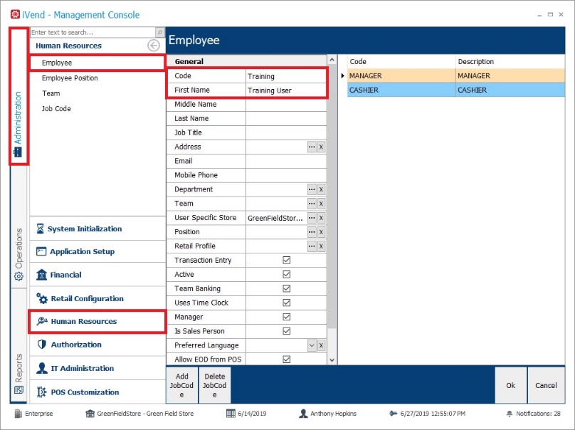

1. To create a dummy employee for a training user, in the Management Console, go to: Administration > Human Resources > Employee. This is an optional step as any user can be given access to the Training database if desired. Refer to the following screen image for guidance on how to setup the Training user.
a. Give the user a unique code and description.
b. Apply other settings as required but the user must be given Transaction Entry permission if they are going to have access to perform transactions at the POS
c. Add a Job Code to the user as required
d. Press [Ok] to save the changes made and to add the Training employee to the system.

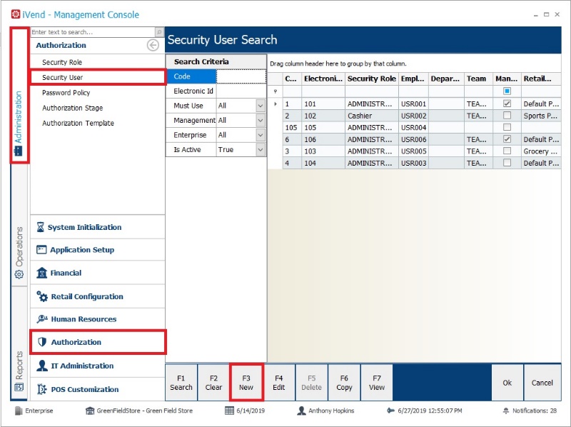

2. Open Security User setup in the Management Console, go to: Administration > Authorization >Security User. Create a new Security User by clicking [F3 New].

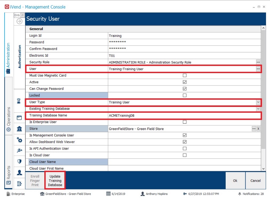

3. Fill in the required information and attach the Training employee that was created above in Step 1.
4. Set the User Type as a Training User.

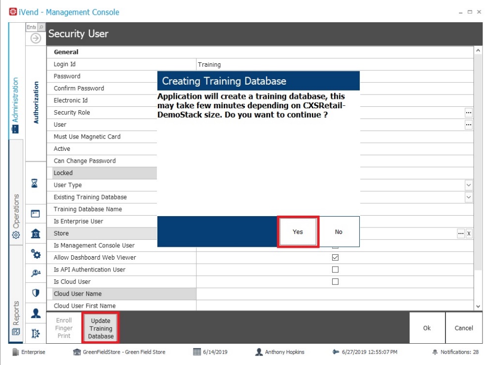

5. Specify Training Database Name (to create a copy of production database for training purposes) and click the [Update Training Database] button. The System will create a training database that is a replica of the live production database. Click [Yes] to proceed on the Creating Training Database pop-up screen to confirm. The system will perform a backup of the live production system and will create and restore it to the Training database – the screen will show a progress meter of the process and can take several minutes to complete, depending on the size of the live production database.
