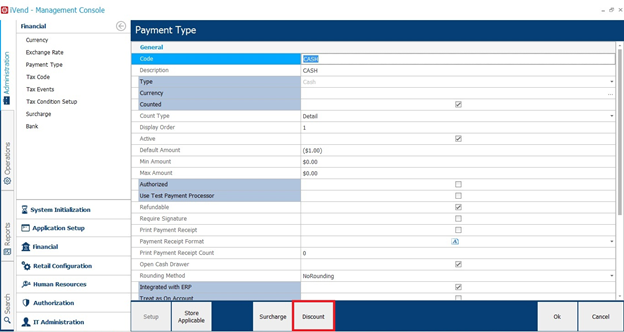

1. Select the desired tender type and press the [F4 Edit] button to enter into edit mode.
The Payment Type window appears.
1. Choose the [Discount] button to define discounts for the selected tender type.
1. The Payment Discount Setup window appears.

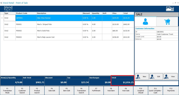

1. At the POS add one or more products to a sale transaction, ensuring that the total value will be greater than the value that we defined in the Payment Greater Than field in the Discount Setup window for the Cash type tender.
1. Press the [F12 Payments] button.

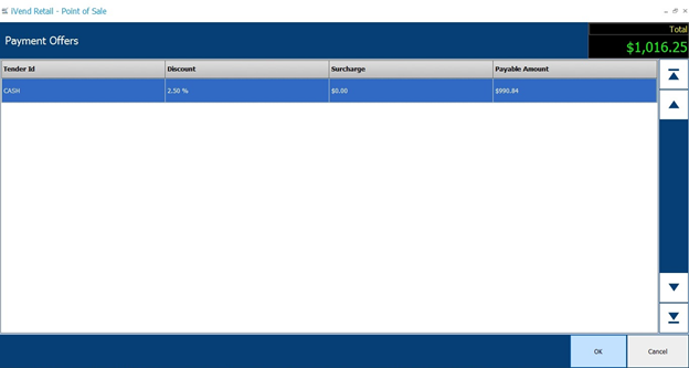

2. The Payment Offers screen appears.
All the tender based Discount and Surcharge offers applicable on the transaction will appear on this screen.
1. Select the desired option and choose [Ok].
Alternatively, choose [Cancel] to close the window, which will then present a list of all available tenders and the user can proceed to select any that are available to process the payment from the customer and complete the transaction.

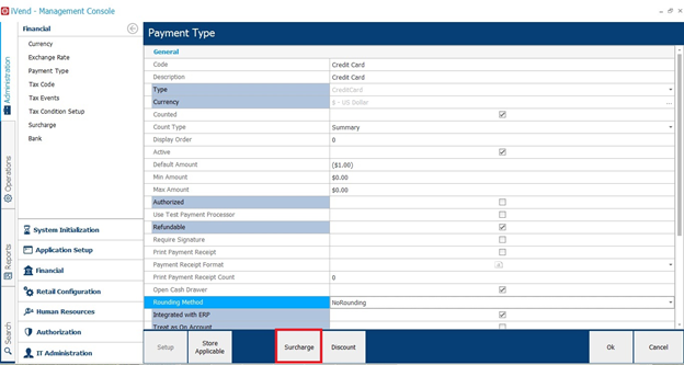

1. Select the desired tender type and press the [F4 Edit] button to enter edit mode for the payment type.
1. Choose the [Surcharge] button to define surcharges for the selected tender type.

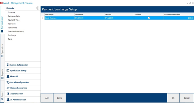

1. The Payment Surcharge Setup window appears.
The following table provides an explanation of the fields and buttons that appear on the Payment Surcharge Setup screen
Field Name
Description/Activity
 Surcharge
Choose radio button (…) to open the Surcharge Search window and select a surcharge.
 Date From
Select the business date from which the surcharge will be applicable.
 Date To
Select the business date to which the surcharge will be applicable.
 Enable
Select the checkbox to enable the surcharge configuration.
 Payment Less Than
Enter the payment value threshold where the surcharge will be applicable for transactions having this payment type, i.e. If the payment is less than this value then the surcharge will be applied.
Buttons
[Add]
This button enables the user to add a new surcharge row.
[Delete]
This button enables the user to delete an existing surcharge row.
[Ok]
This button saves and updates changes made to the Discount Setup screen to the database and closes the window.
[Cancel]
This button closes the window without saving any changes and will not update the database.
5. Choose [Add] to add a surcharge row to the configuration.
6. Select a Surcharge from the look-up and set the Date Range that the surcharge will be applicable for.
7. Select the Enabled checkbox to make the surcharge line active.
8. Set the value threshold where the surcharge will be applied if the payment is less, in our example we have set this to be $50.
9. Multiple surcharges can be configured for other date ranges if desired.
10. Choose [Ok] to save the changes made on the Payment Surcharge Setup screen and to return to the Payment Type window.
11. Choose [Ok] on the Payment Type window to save the changes made.

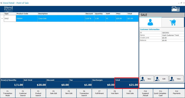

1. At the POS, add one or more products, ensuring that the transaction total is less than the threshold set in the  Payment Less Than field on Payment Surcharge Setup window for the Credit Card type tender.
2. Press the [F12 Payments] button.
