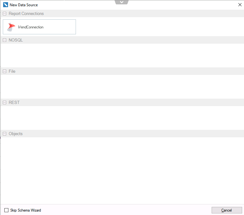

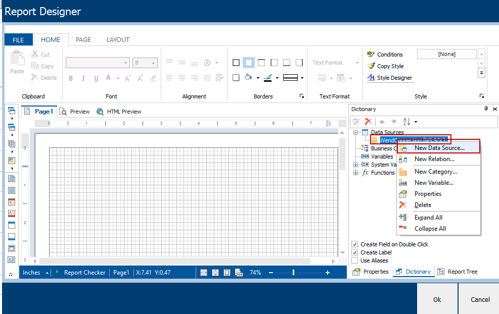

On the report Designer right clock on the iVend Connection under the Data source. Then click on New Data Source
Figure 1 Report Designer
Click on iVend Connection on the Data Source screen

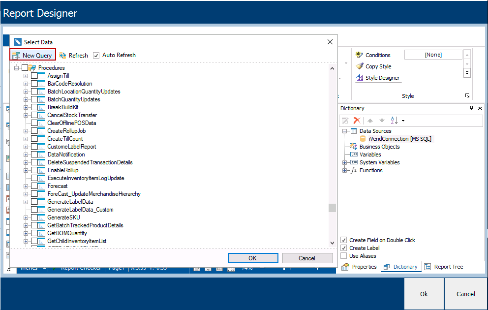

Click on New Query on the Data Select Screen.
Figure 3  Report Designer-New Query

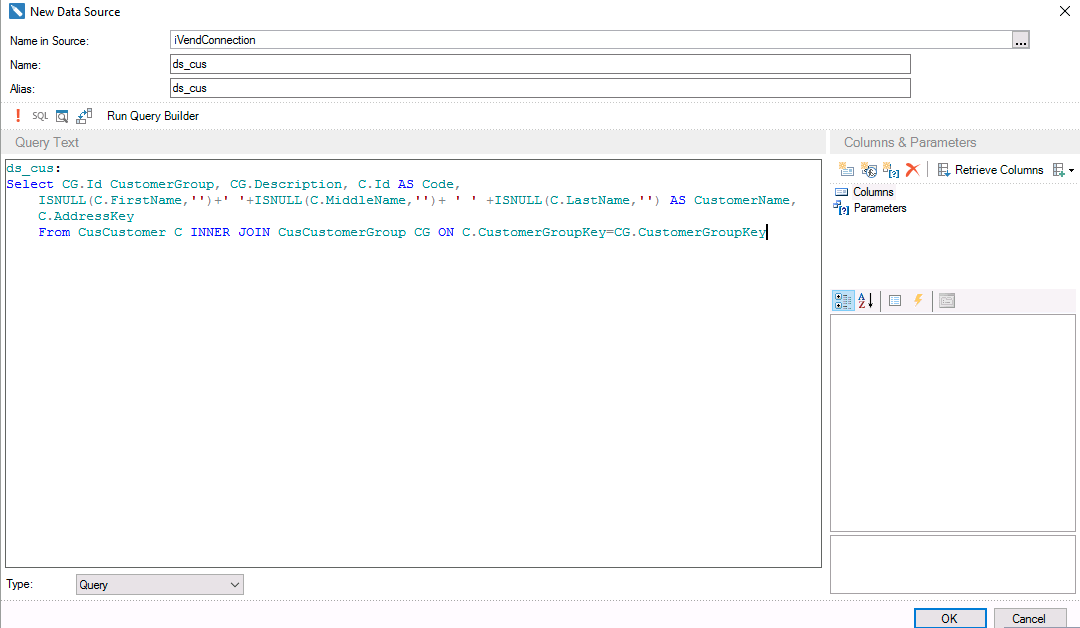

In Query screen enter the query for the item for which report is required. Like in this case item name is Customer.
Figure 4 SQL Query

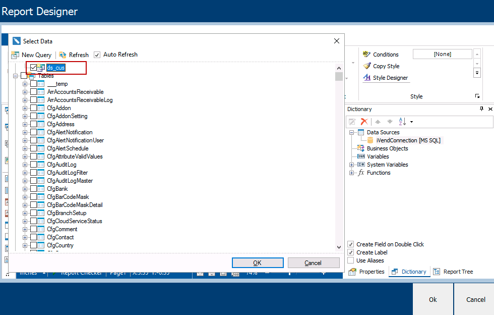

The customer table gets created and is displayed on the Select Data Screen. Select the check-box for newly created table
Figure 5 Report Designer

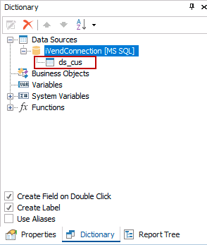

The Table gets added to the Data Source in the Dictionary
Figure 6 iVend Connection

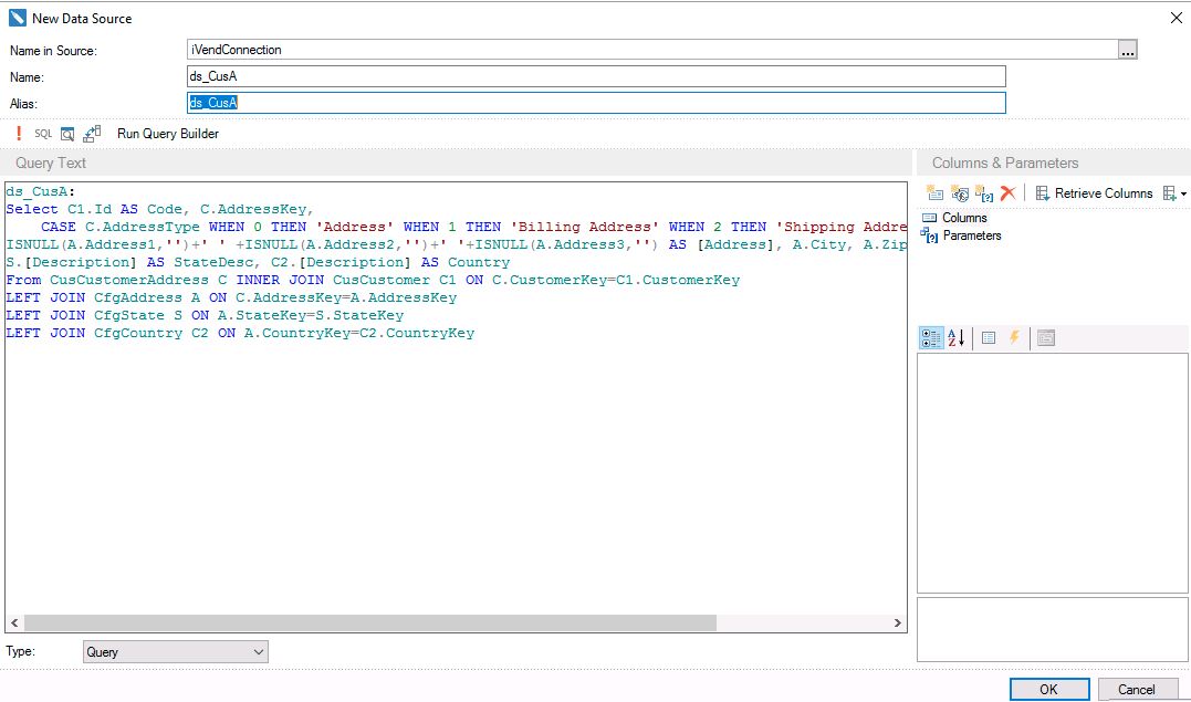

Now create new Data Source with query. Click Ok to reflect the new Data Source which will be Sub data in report.
Figure 7 New Data Source Query

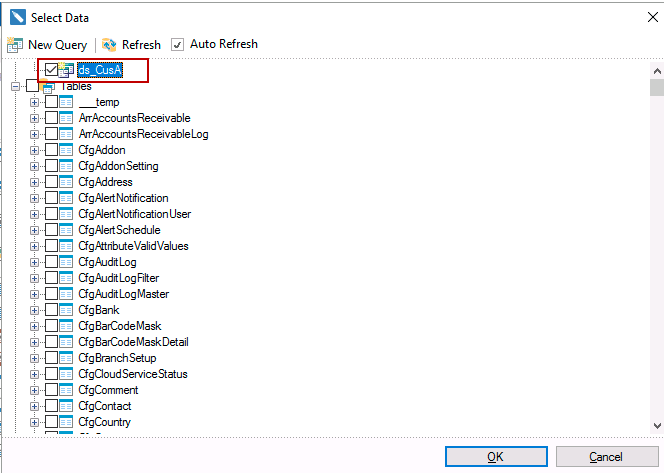

Select the new created table and click Ok.
Figure 8 Select Data

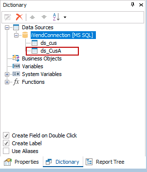

The new Data Source which is our Sub report data, gets added and listed in the Dictionary
Figure 9 Dictionary -iVend Connection

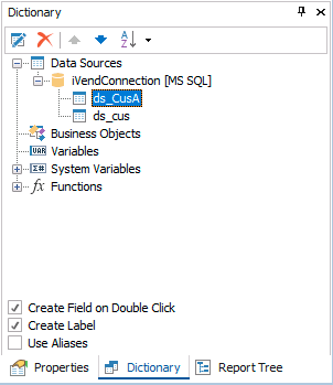

On the Dictionary, select the Data Source which needs to be a sub data in report should be moved  up above the main data in report. Like in this case since ds_CusA is sub-data of ds_Cus, the ds_CusA is moved above the ds_cus datasource.
Figure 10 Dictionary –move up ds_CusA
Note: This is an important step for the sub data to be displayed in the reports.

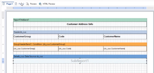

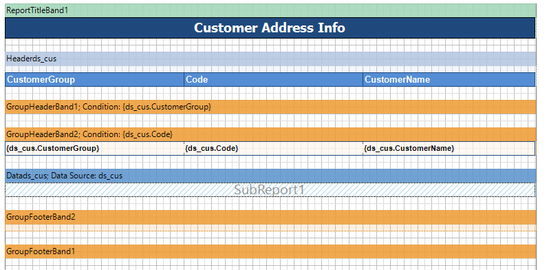

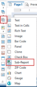

Now create report layout for main report. Like in this case report layout for ds_cus.
Figure 11 Sub Report
Figure 12 Sub Report Layout

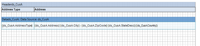

Create SubReport Layout for Sub-Report. Like in this case for ds_CusA
Figure 13 Report Layout
Figure 14 Header CusA

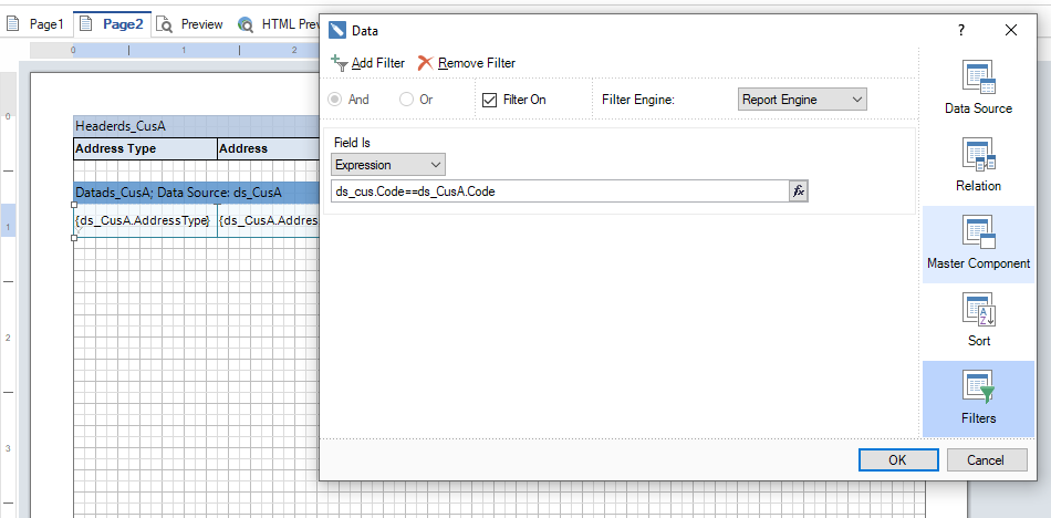

Double click on Data band, select filter option to make a relationship between main report and sub report.
Figure 15 Select Filters

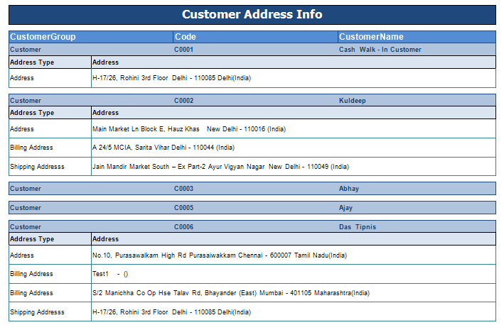

Preview the report by clicking on the preview button. The report displays the Report data and also the Sub-Report Data.
Figure 16 Customer Address Info
