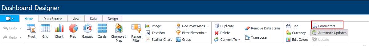

To create dashboard parameters in the Dashboard Designer, perform the following:
· Click the [Parameters] button on the Ribbon's Data Source tab.
Figure 1 Dashboard Designer

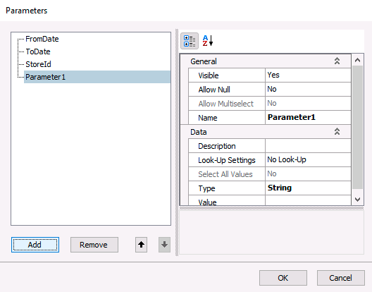

· In the invoked dialog, click the [Add] button to add a new parameter.
Figure 2 Parameters
· Specify the following settings.
Settings
Description
Name
Specifies a parameter name.
Value
Specifies a parameter value.
Type
Specifies the parameter type.
Description
Specifies the parameter's description displayed to an end-user.
· Then, click [Ok], to include the created parameters in the dashboard.

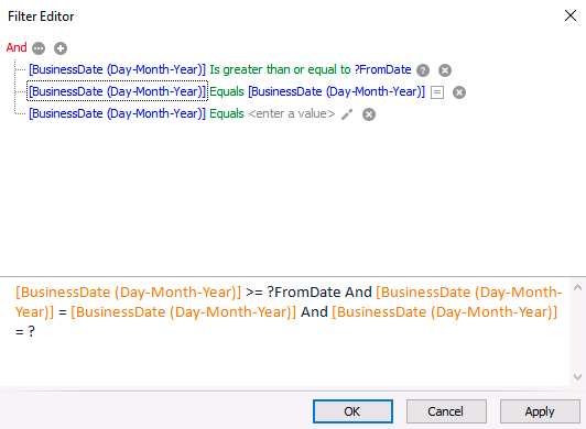

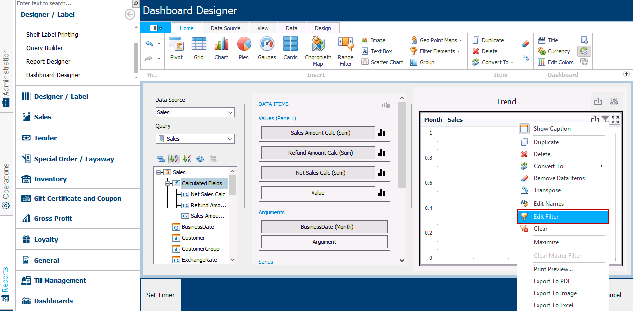

In this topic, you will learn how to pass parameter values to a dashboard. You apply filtering to a specific dashboard item according to the current parameter value using the Edit Filter.
Figure 3 Dashboard Designer-Edit Filter

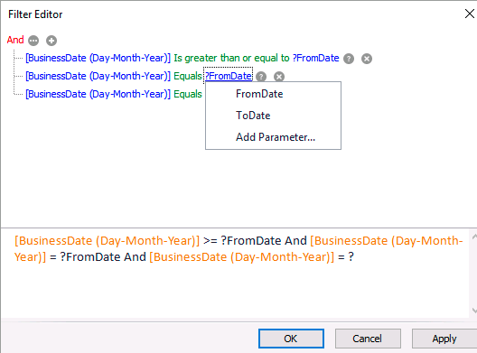

In the Filter Editor, you can compare a field value with the following objects.
· A static value (represented by theicon). Click this button to switch to the next item mode ("another field value"), to compare the field value with another field value.
· Another field value (represented by the  icon). Click this button to switch to the next item mode (parameter value), to compare the field value with a parameter value.
· A parameter value (represented by the  icon). Click this button to switch back to the initial mode ("static value"), to compare the field value with a static value.
Thus, to compare a field value with a parameter value, click the  button, then click the  button.
Figure 4 Filter Editor
