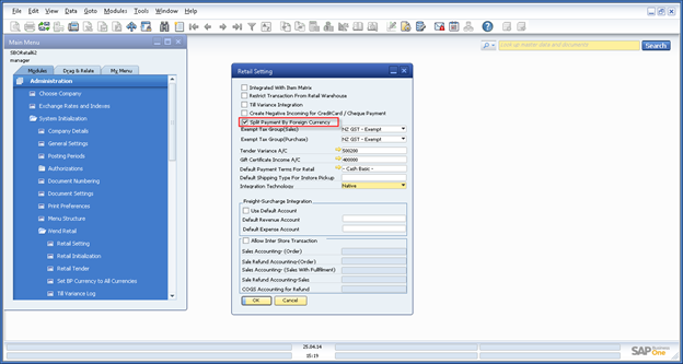

1. In SBO, choose Administration > System Initialization > iVend Retail > Retail Setting
Select the option, Split Payment By Foreign Currency check box.

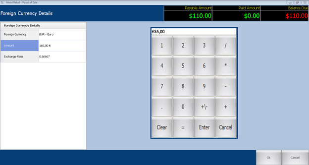

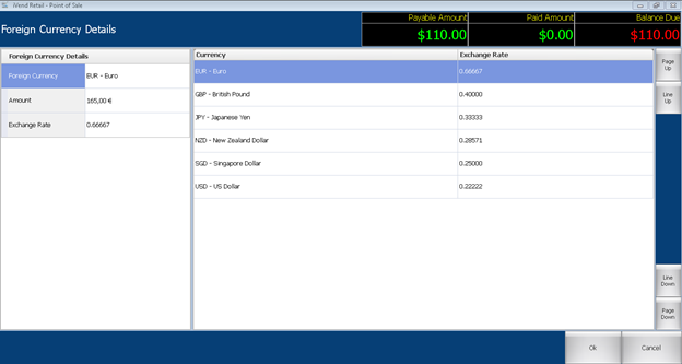

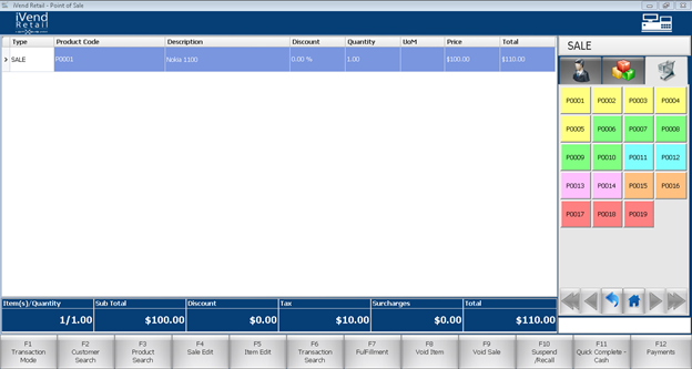

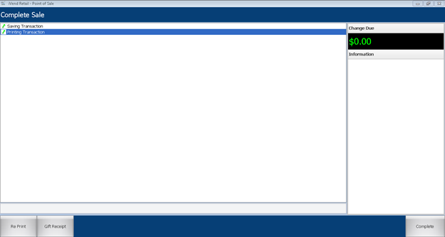

1. Now let us receive a multi-currency payment at the POS for a transaction with a total of $110 in the base system currency – View the following screen images for a guide.

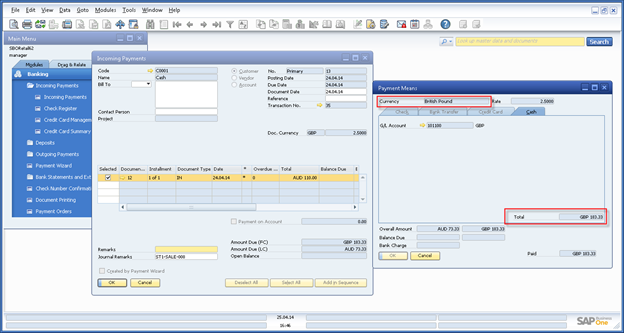

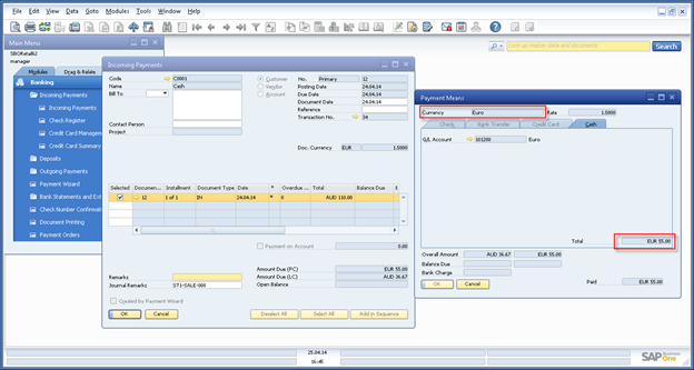

1. Now let us check this multi-currency payment transaction in SBO – View the following screen images for a guide.
