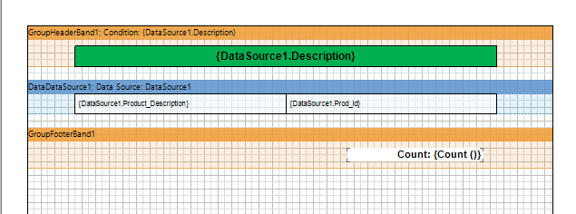

1. Design a report or load and existing one. For example, take a group report, which was reviewed in the separate article called, "Report with Grouping". The picture below shows a report template with groups:

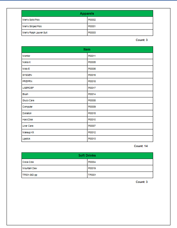

1. Click the [Preview] button or invoke the Viewer by pressing F5 or clicking the Preview menu item. After rendering a report all references to data fields will be changed ithe data from the specified fields.

1. Select the GroupHeaderBand.

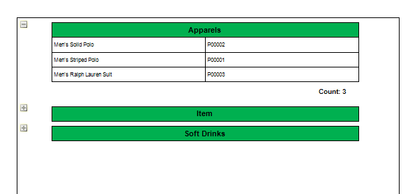

1. Set the Interaction.Collapsing Enabled property to True.
1. Change the value of the Interaction.Collapsed property. In our case, set the Interaction.Collapsed property to {GroupLine! = 1}. So, when rendering a report all the groups except the first one will be collapsed.
1. Click the [Preview] button or invoke the Viewer by pressing F5 or clicking the Preview menu item. After rendering the report all references to data fields will be changed ithe data from the specified fields.
 Drill - Down Report

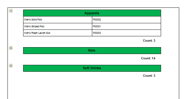

To expand or collapse a group you can click on the GroupHeaderBand in the rendered report. If it is necessary for the group to be collapsed together with the group summary, then the Interaction.CollapseGroupFooter property should be set to True. The picture below shows the report page rendered with the collapsed report:
Drill - Down (Footer Collapsed) Report
