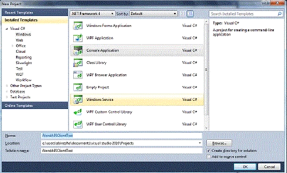

· Create a new application "iVendAPIClientTest" as shown in Figure
Figure

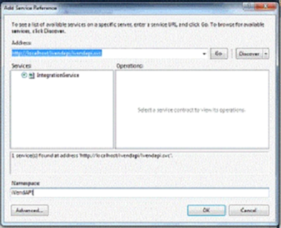

· In the Add Service Reference screen, input the address of the iVend service and then click the [Go] button. This lists down the iVend services under the 'Services' list of the Add Service Reference screen.
Figure

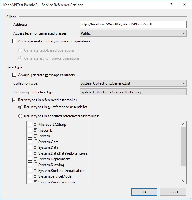

· Then select "Configure Service Reference" from the list.
· Change the "Collection Type" to "System.Collection.Generic.List" and then click the [Ok] button.
