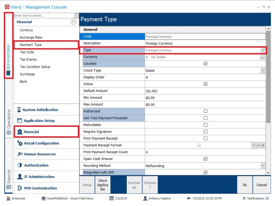

Foreign Currency (Payment Type) Tender: Define a new Tender in the Management Console. Select Foreign Currency in the Type field in the Payment Type Creation screen – refer to the following screen image for guidance.
Once the tender is defined, the user can set the applicability for the store(s) as required.
After completing the setup of the Foreign Currency Tender (Payment Type), restart the POS so that the new tender will be available to use on the Payments screen.

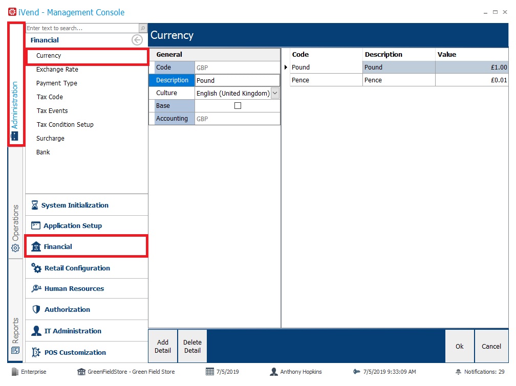

The user will also need to ensure that they have setup the currencies and entered the exchange rates applicable for the current trading business day – refer to the following screen images for guidance.

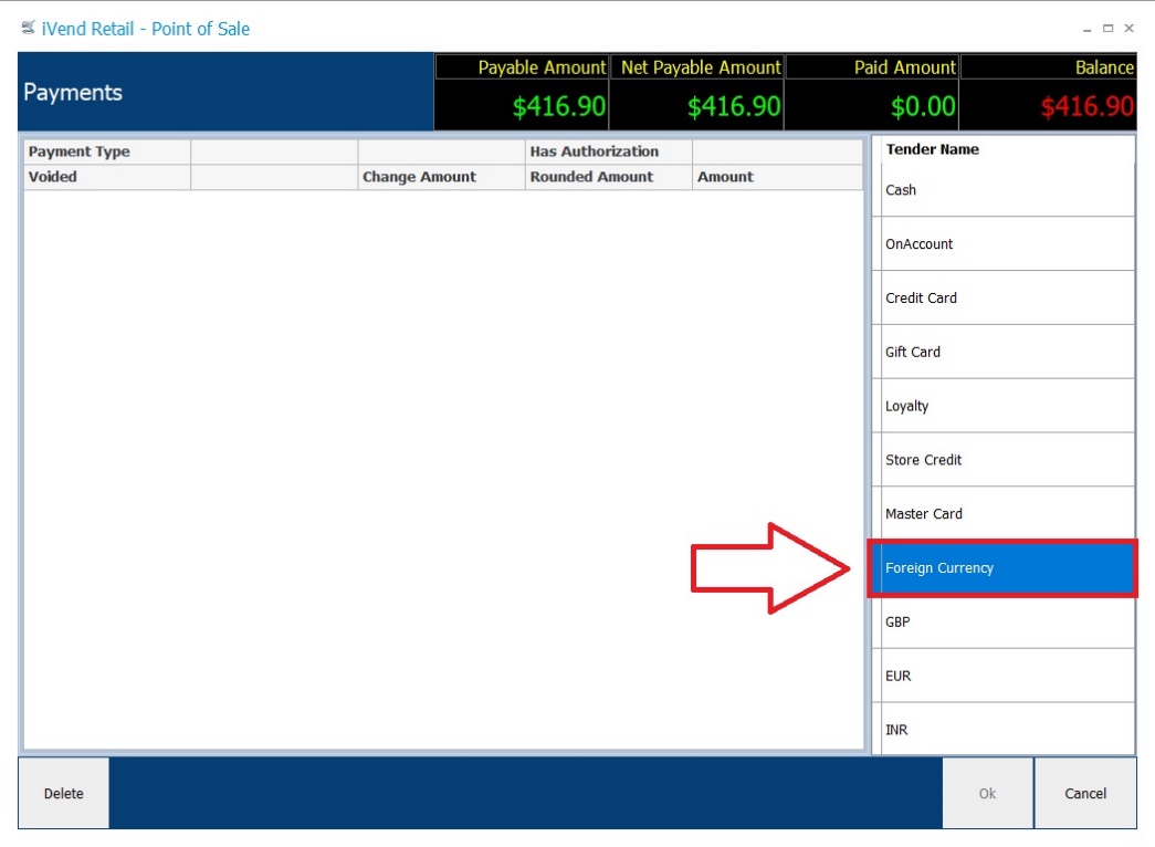

The user at the POS can now receive payments through the Foreign Currency Payment Type by selecting the tender on the Payments window as shown in the following screen images:

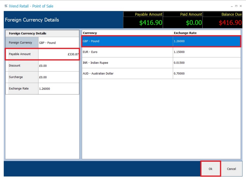

After clicking on the foreign currency tender type, the user will be taken to the Foreign Currency Details screen and there they need to select the currency against which customer would like to pay for their purchase with. For example, if the system base currency is USD and customer would like to pay in Great British Pounds Sterling, then the user would need to select the appropriate foreign currency of GBP (Great British Pounds) as shown in the screen image below
As soon as the user selects the currency on the basis of the defined exchange rates of the day; the system converts the amount and displays it on the Foreign Currency Details screen as displayed in the above screen image.
Clicking on the [Ok] button will process the payment; the system accepts the payment with the selected tender and it completes the transaction in foreign currency.

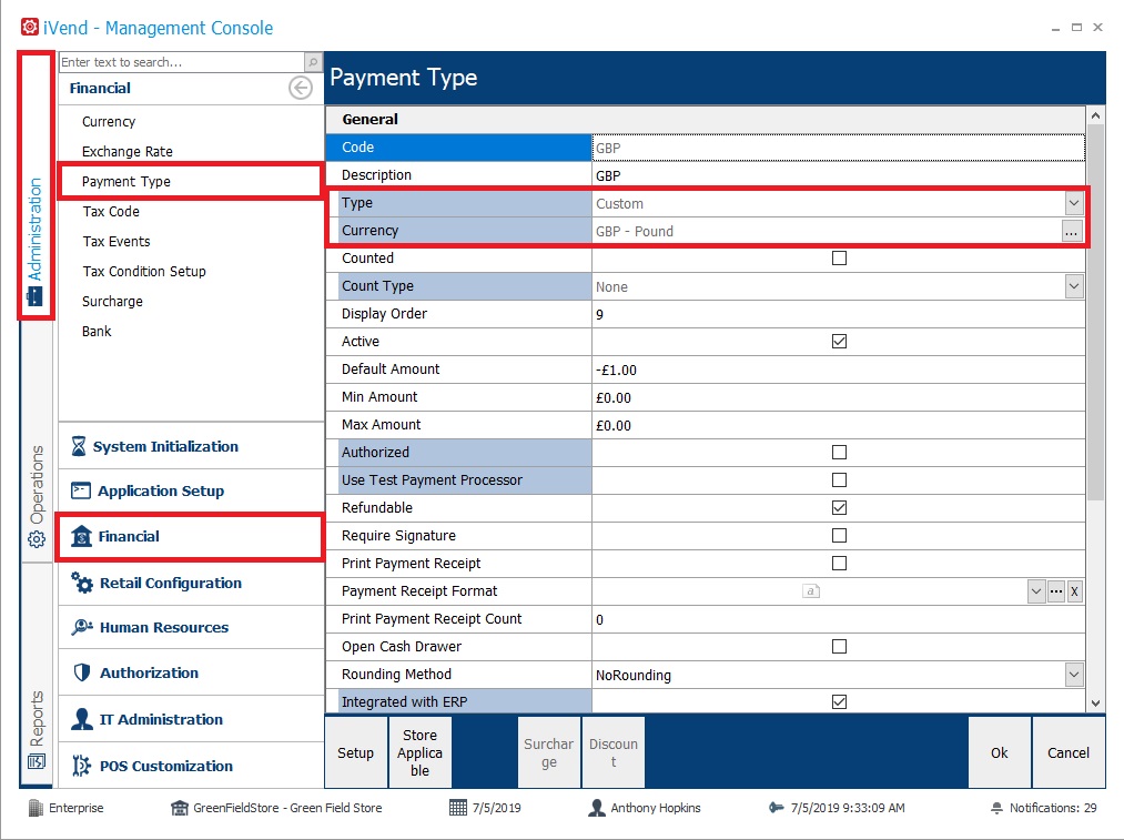

1. Create a Tender type in the system apart from the Foreign Currency by Selecting the Type as Custom.
When the user sets the Type field as Custom, the Currency field becomes available and active where the user can then select the currency as Great British Pounds from the Look up […] as shown on the above screen image.
In an integrated scenario; after creating the tender type in the iVend Management Console, the user must map the tender with a specific G/L Account in the ERP. This would allow the posting to the ERP via the integration of the transactions performed at the POS where this tender type was used.

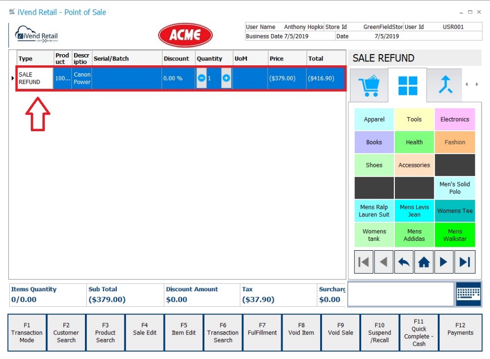

3. Go to the iVend POS and select a transaction against which the user would like to perform a refund:

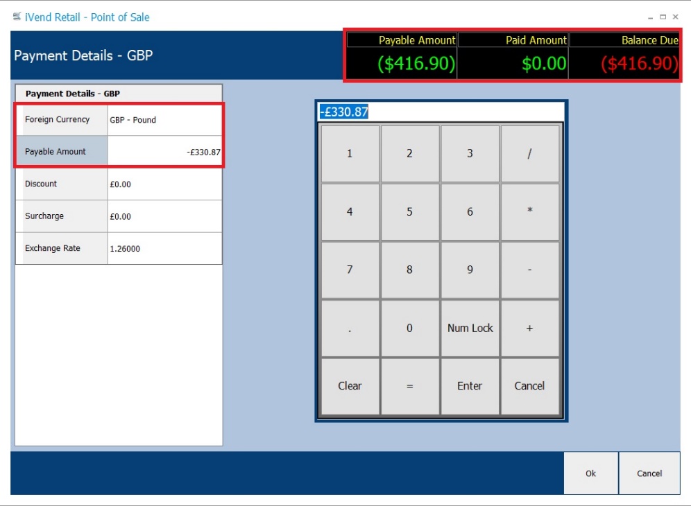

4. On the Payments screen, go to the Payment Tender options and select the currency as GBP - Pound to perform the refund using the GBP foreign currency.
While selecting the payment type GBP – Pound, the user can provide a Cash Back to the customer in the same currency as paid by the Customer during their purchases.
