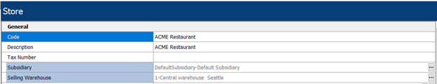

Subsidiary
Subsidiaries are best defined as smaller, sub-companies of a big conglomerate. All the subsidiaries may have different or similar lines of business.
In context of iVend Retail subsidiaries are defined when the big conglomerate has retail operations in different countries.
Since the subsidiaries are in different countries, the currencies and taxes will be different.
Different currency and taxes impact other masters like pricing, discounts, promotions, etc. Quite a few relevant setups and their structure are entirely changed internally to be in accordance with the subsidiary model.
It is therefore not possible to ‘switch off’ subsidiaries once they are enabled.

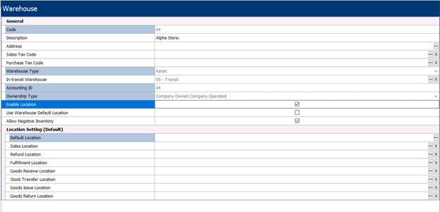

Location and Default Location
Locations are logical segregations defined in the application that allow retailers to manage their in-store inventory better. By defining locations, retailers can control the stock levels that have to be considered for sales. For example, the retailer can define a location ‘returned goods’ where all the returned products are kept. The retailer can also control whether or not the stock in this location is to be considered for sale at the point of sale.

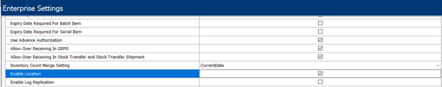

Once this setting has been enabled, the warehouse definition screen will have the option to specify whether or not locations are applicable to the particular warehouse
As soon as the locations are enabled at the warehouse level, all transactions expect a location to be specified from where the products are either being sold OR returned to.
When locations are switched ON for the warehouses, the inventory is allocated all the way to location level. This inventory cannot be allocated back to warehouse level by simply turning off the locations setup.
Once a warehouse has locations enabled, it is not possible to switch OFF this setting for the warehouse.

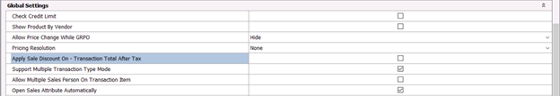

Apply Sale Discount on Transaction Total After Tax
Tax jurisdictions have different ways of managing discounts. This global setting allows retailers to offer discounts AFTER the tax has been applied to a transaction.
By default, this setting is switched OFF, which means the application will FIRST apply discounts and THEN apply the taxes.
Switching this setting ON has an application wide impact.
Once switch ON it is NOT possible to switch this setting OFF

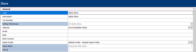

Store Mode (Enterprise with Store / Store)
This is a setting specified while defining a Store. For not-so-large retail setups the retailer may prefer to have the Enterprise server ALSO double up as the Store Server.
In this case the Store Mode of the store is specified as ‘Enterprise with Store’
This further means that while the server will have all the Enterprise functions, it will ALSO have ‘store specific’ functions and processes like ability to carry out back-office inventory transactions.
Please note that only one store can be configured as ‘Enterprise with Store’
This is an irreversible setting because once set, the application configures all store functions in the Enterprise Server.
This setting is irreversible as if one store which was marked earlier as ‘Enterprise with store’ is marked simply as store, then the enterprise will not have any other store which is marked as ‘Enterprise’, to avoid any such conflict, this setting has been marked as irreversible.

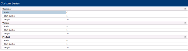

Enterprise Custom Series - Customer, Vendor and Product
Numbering series to define Customers, Vendors and Products can be defined at the Store level. However, in case these numbering series are NOT defined at the store level, the application looks for this numbering series at the Enterprise level.
These ‘fall back’ series are defined at the Enterprise level during the initial setup and cannot be changed later.

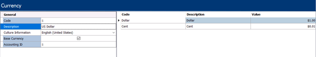

Base Currency setup
Predictably, there can only be one base currency in which the retail environment will work. Additional currencies can also be defined and can be used in transactions by specifying the exchange rates with respect to the base currency.
The base currency is the reference to various exchange rates in case of foreign currency is being used. If the base currency itself has been changed every other currency will lose its reference point, and every historical and future transaction will be affected.
It is for this reason, once set, the base currency cannot be changed.
Warehouse mapping for a store
A store in iVend Retail is linked to a retail-type warehouse for it’s inventory movements.Every transaction that happens on store affects inventory on the mapped warehouse.
This setting cannot be changed or deleted as it would befoul the existing and future inventory records. For example, if the mapping has changed and a cashier wants to do a refund, it will reinstate the inventory on the wrong warehouse after changing the mapping. This type of mix up will also be observed in all other transactions related to the store such as fulfillment, business transactions etc.
