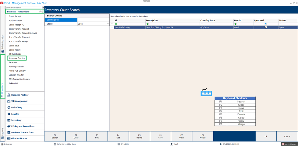

Log into the iVend Management Console and navigate to: Operations > Business Transactions > Inventory Counting – the inventory Counting Search screen comes up.
      Figure 1 – Inventory Counting Search Screen
Steps to create a new Inventory counting
1. On the Inventory count screen, search for an existing count and press the [F4 Edit] button to edit the existing open count or click on the [F3 New] button to create a new count.

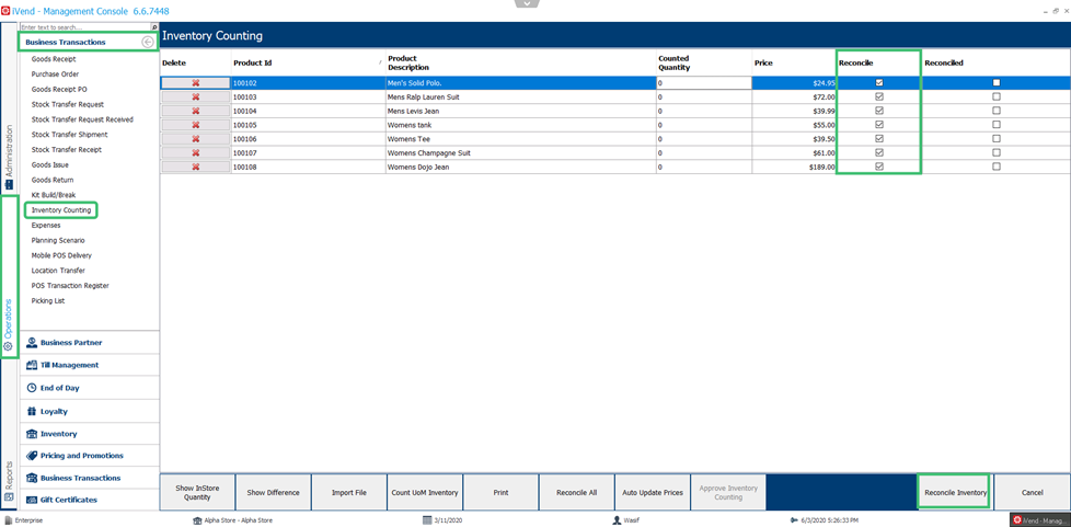

[Reconcile Inventory]
This button reconciles all of the items that have been marked ready for reconciliation. If the differences are positive then the system will automatically generate and post Goods Receipt transactions and if the differences are negative then the system will also generate and posts Goods Issues transactions automatically.

On the Inventory Counting screen, the Inventory Counting Process can be executed in two (2) ways:

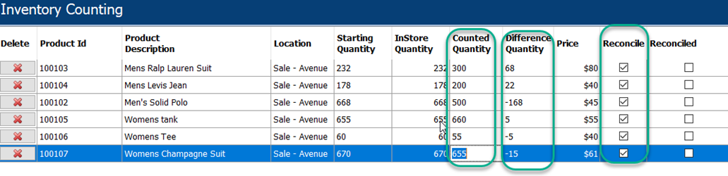

a. Manual Counting: - In this process, the user has to enter the physical quantity in Counted Quantity field. Based upon the entered values, differences in the quantities will be calculated automatically. After entering the values, the Reconcile flag is checked by the system.
                                                      Figure 4 – Inventory Counting Screen
As per the above screen image, the difference is calculated by the system based upon the entered Counted quantity.
As an example, in the first row, the In-stock quantity is 232 and the Counted quantity is 300 which is higher, therefore the difference in the quantity calculation is:
Counted Quantity – In store Quantity
300 – 232 = 68 [A positive difference – When reconciled, the system will produce a Goods Receipt for this line item variance]
And if we look at the third row, the In-store quantity is 668 and the Counted quantity is 500 which is lower, therefore the difference in the quantity calculation is:
500 - 668 = (168) [A negative difference – When reconciled, the system will produce a Goods Issue for this line item variance]
To confirm, based upon the type of differences, the system will generate and post the Inventory transactions as follows:
· If Difference Quantity is on the Positive side, then the system will create Goods Receipt transaction documents automatically when the user clicks on the final button, [Reconcile Inventory].
· If the Difference Quantity is on the Negative side, then the system will create Goods Issue transaction documents automatically when the user clicks on the final button, [Reconcile Inventory].

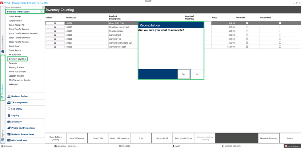

4. Once the physical inventory count has been updated as per Step 3, click on the [Reconcile Inventory] button to complete the process, the system will produce a pop-up message asking the user to confirm that they wish to proceed further – Click [Yes] to proceed or [Cancel] to cancel the reconciliation process.
                                   Figure 5 – Reconciliation Pop Up Screen

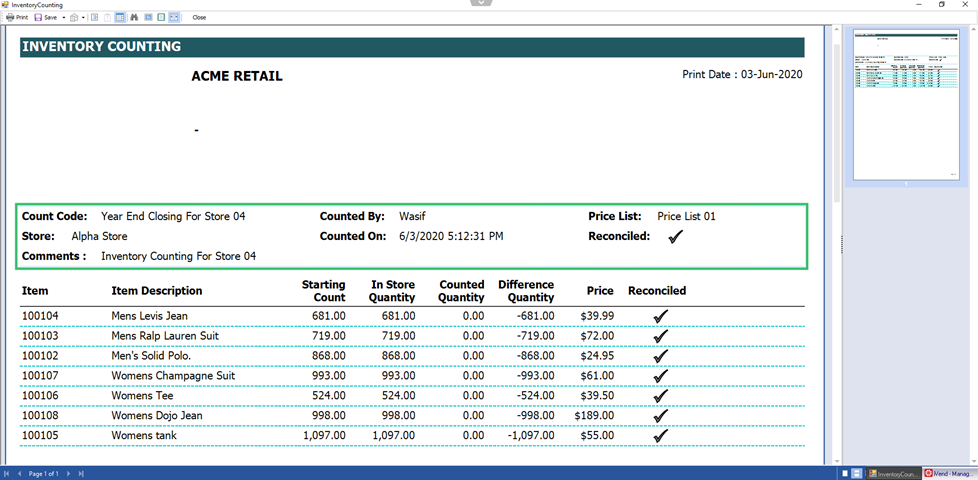

After clicking on the [Yes] button, the system will create the reconciled inventory document showing the differences in quantities should they exist. The user can also print this out for the inventory counting process.
                                            Figure 6 – Inventory Counting Receipt
Note: Based upon the above differences, the iVend system will post the Goods Receipt and Goods Issue documents, which can be viewed via the Management Console.
Goods Receipt path: Operation > Business Transactions > Goods Receipt
The Goods Receipt document will be posted on the date used to reconcile the Inventory Count.
Goods Issue Path: Operation > Business Transactions > Goods Issue
The Goods Issue document will be posted on the date used to reconcile the Inventory Count.
