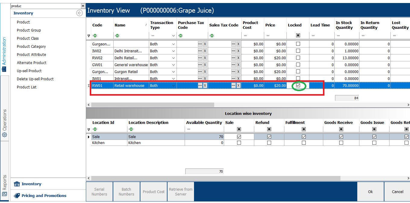

One of the possible cause is that one / more item involved in the stock count is/ are marked as locked for the concerned warehouse, for which stock take was performed. Refer to below image:
Resolution:
If the item is found to be locked then uncheck the Locked checkbox against the warehouse for the concerned item and Re-perform inventory counting and this should solve issue.
