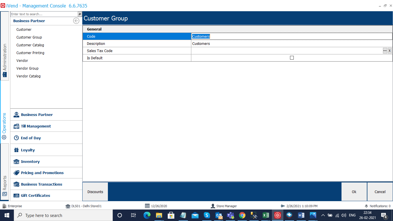

We have checked the customer groups code which were not matched with SAP HANA. We have corrected the customer group codes from Customer Group screen and saved the same.
Now we come to integration failure monitor and re-tried all five-failure records and later all integrated successfully.

Please correct all customer group codes in iVend from Customer Group Screen and code should be same as in SAP HANA.
