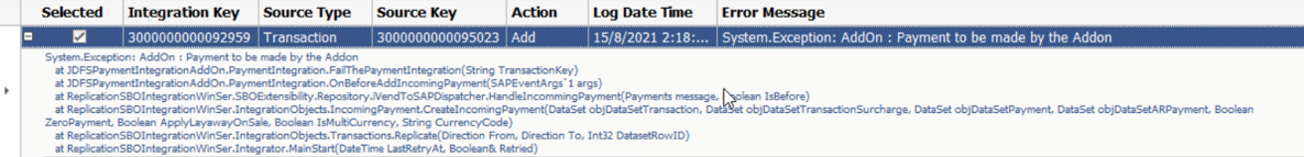

Problem Statement :
Transactions are not integrating with iVend To SAP.bIt is showing an error message.
System.Exception: AddOn : Payment to be made by the Add-on
JDFSPaymentIntegrationAddOn.PaymentIntegration.FailThePaymentIntegration
