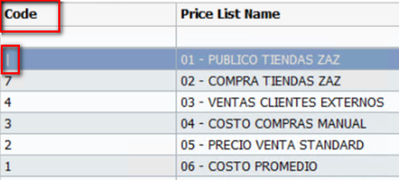

The Retail Price-List code was changed by a user in the iVend mistakenly, putting an “I” instead of the number “6” that originally was the Price list code. Means, SAP has the Price-list Code "6" however it is "I" in iVend now, this is why the Integration monitor was throwing a data type error.
So in the Management Console, replace the "I" code with "6" again and It should start integrating.
Below is the incorrect Code Screenshot in iVend which needs to revert "6"
