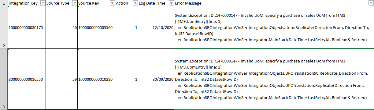

Failed Integration records from iVend to SAP Source type 46 (product), error
"System.Exception: DI:1470000147 - Invalid UoM; specify a purchase or sales UoM from ITM3 [ITM9.UomEntry][line: 1] en
ReplicationSBOIntegrationWinSer.IntegrationObjects.Item.Replicate(Direction From, Direction To, Int32 DatasetRowID)en ReplicationSBOIntegrationWinSer.Integrator.MainStart(DateTime LastRetryAt, Boolean&) Retried "and for Sourcetype 59 (UPCTranslation) also error:
"System.Exception: DI:1470000147 - Invalid UoM; specify a purchase or sales UoM from ITM3 [ITM9.UomEntry][line: 1]en
ReplicationSBOIntegrationWinSer.IntegrationObjects.UPCTranslation90.Replicate(Direction From, Direction To, Int32 DatasetRowID)en ReplicationSBOIntegrationWinSer.IntegrationObjects.UPCTranslation.Replicate(Direction From, Direction To, Int32 DatasetRowID)
en ReplicationSBOIntegrationWinSer.Integrator.MainStart(DateTime LastRetryAt, Boolean& Retried)"
Below is the screenshot of the errors:
