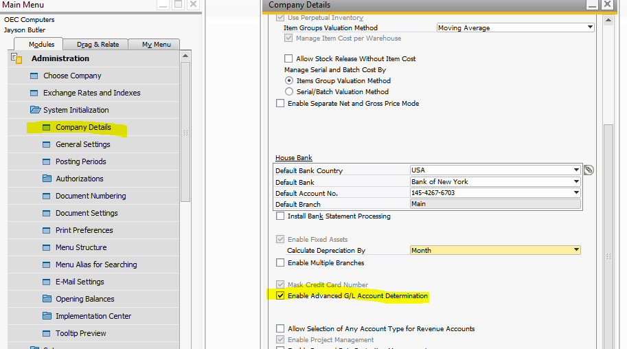

Please check the below settings in SAP:
Got to Administration >> Company Details >> Find the status of the "Enable Advanced G/L account determination" field

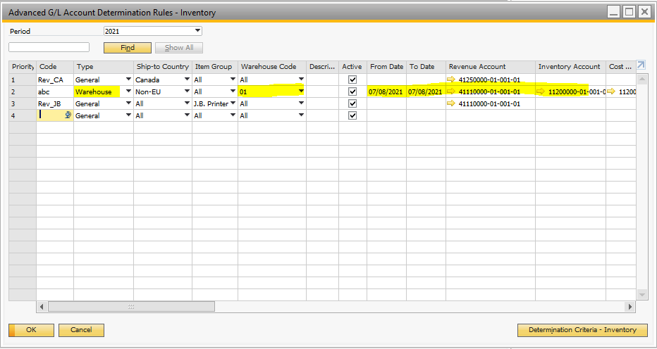

If the “Advanced G/L Account determination” is enabled then Revenue Account must be defined for the Warehouse and the Business Date. Please check below.
Open the G/L Account Determination. Select the Inventory Tab and Click Advanced.
Make sure that there is a Revenue account defined for:
Warehouse (Booking or Delivery Warehouse based on the highlighted setting in the “Retail Setting” screen)
Business Date must fall between “From Date” and “To Date”
If the “Advanced G/L Account determination” is NOT enabled then Revenue Account must be defined for the Warehouse in the Warehouse Screen.
