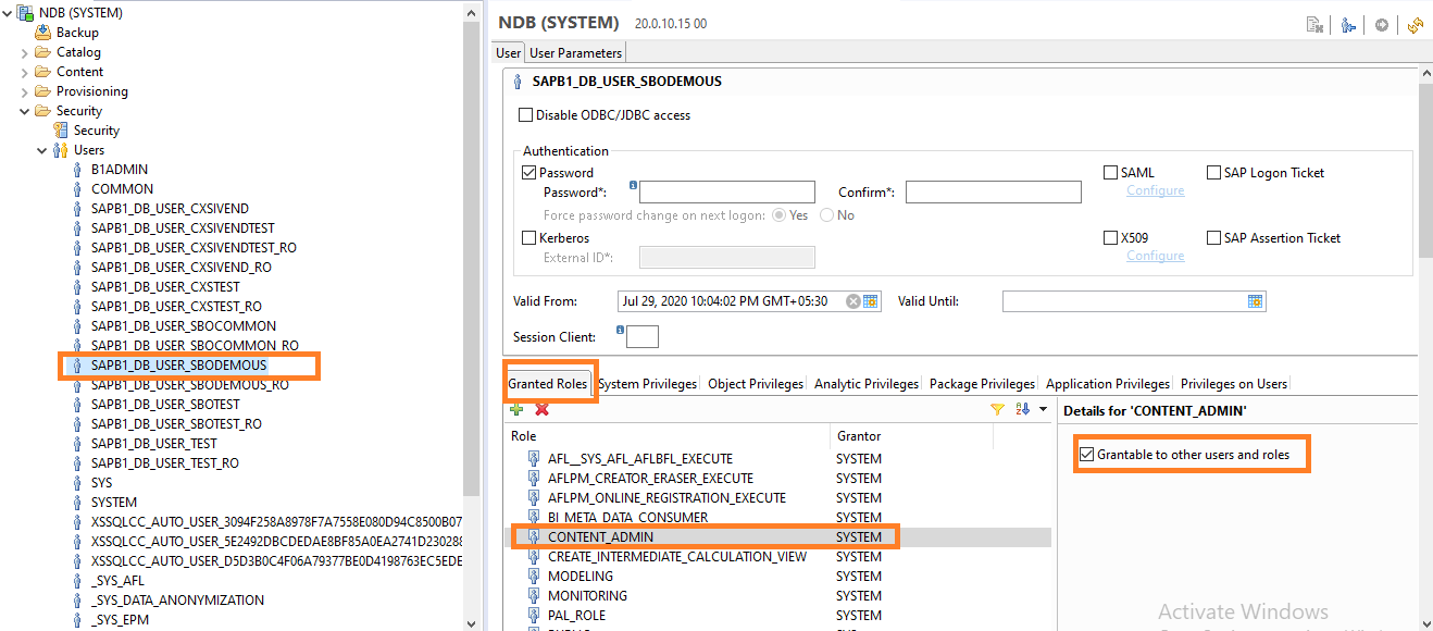

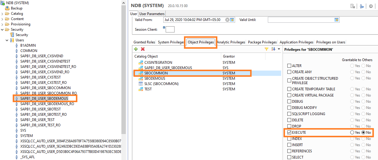

For every SAP Business One company database, there is a user created in HANA. For example, if the Company database name is ‘SBODEMOUS’ then the HANA user name would be ‘SAPB1_DB_USER_SBODEMOUS’.
This user must have the Roles granted as ‘CONTENT_ADMIN’ and the Object Priviledges granted to ‘SBOCOMMON’ as per the below screenshots.

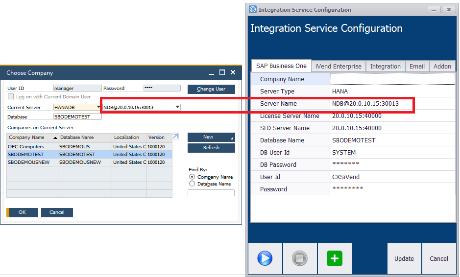

Server Name
HANA Server Name : Port

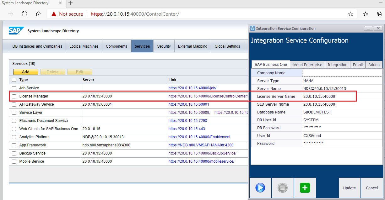

License Server Name
SAP License Server : Port

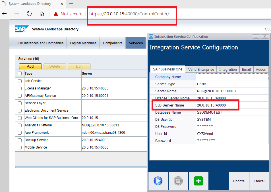

SLD Server Name
SLD Server : Port

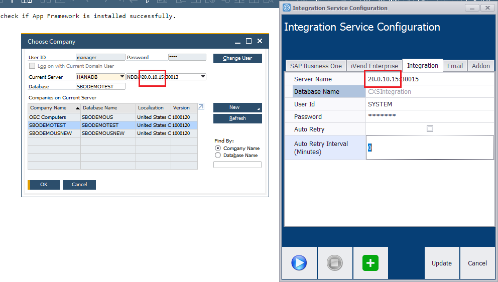

Please refer to the below screenshots.

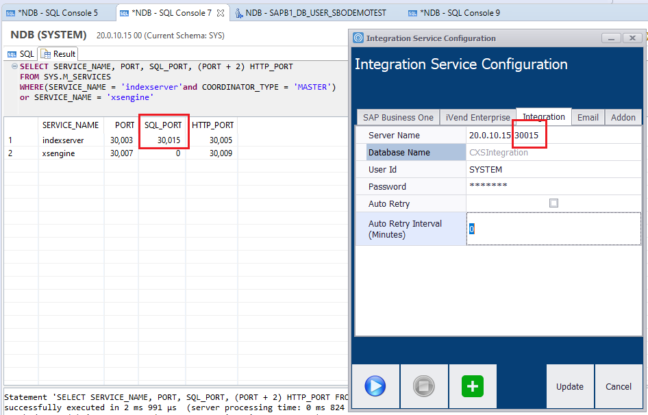

Note: The below query can be executed on ‘SYS’ database to find the Port address for configuring the Integration Tab.
SELECT SERVICE_NAME, PORT, SQL_PORT, (PORT + 2) HTTP_PORT
FROM SYS.M_SERVICES
WHERE(SERVICE_NAME = 'indexserver'and COORDINATOR_TYPE = 'MASTER')
or SERVICE_NAME = 'xsengine'
Click on Update Button to save and update the configurations.
