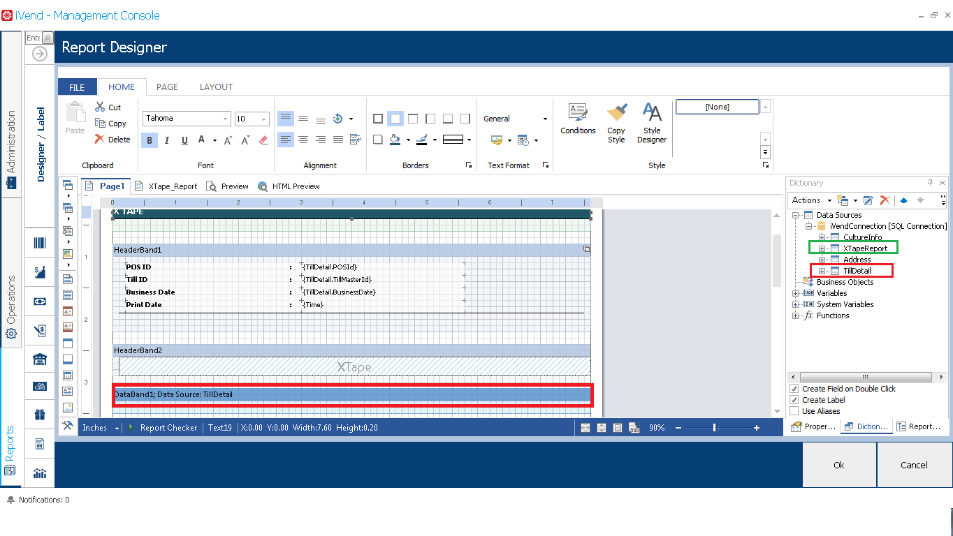

If using sub report, then Sub report “DataSource” should be place upper side of main report DataSource.
  1. “XTapeReport“ Data-Source which used in sub-report.
  2. “TillDetail” this Data-Source is use in Main report
  3. Main Report Data band using the Data-Source.
  4. Place the sub report in main Band where we want to print the Sub-Report data.
  5. Sub-Report DataSource place before the main report DataSource.
