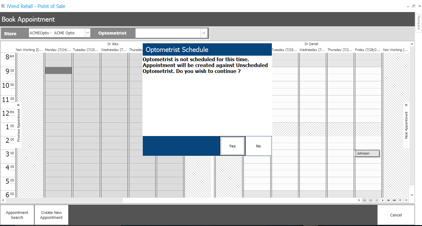

3. The Book Appointment screen provides the option to directly create appointments against a time slot for which an Optometrist is not scheduled by just double clicking on a time slot on the Scheduler screen or by right clicking on a time slot and then by selecting the option New Appointment or click on the button, [Create New Appointment] in the button panel.
4. The following confirmation box will appear:
5. Click on [Yes] to book an Appointment without an Optometrist scheduled for the selected time slot.

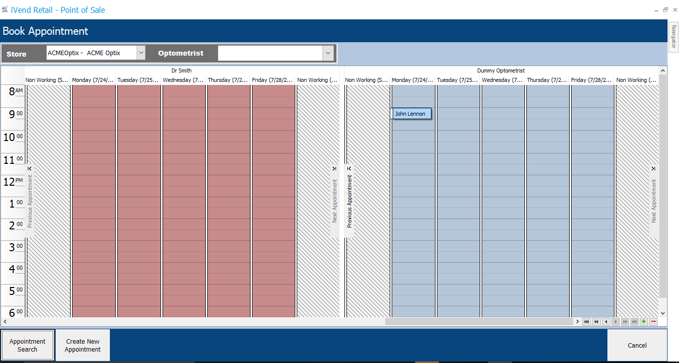

On the Book Appointment screen, that the Appointment booked against an unscheduled Optometrist are visible under the time slots of “Unscheduled Optometrist” and will need to be linked to an Optometrist Schedule for further processing.

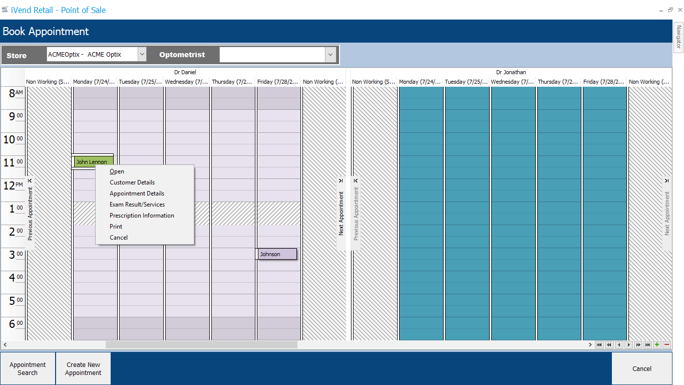

3. Select the Appointment which is to be processed by double clicking on it or by selecting the options available by right clicking the selected Appointment to open the Appointment Detail screen.
4. The Appointment Details screen opens up to display Customer Information and the Appointment Details tabs, which were captured at the time of booking the Appointment.

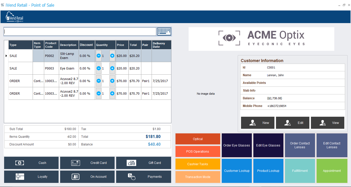

7. Once all the required information is captured, click on [Ok] to save the data, or directly click on [Charge Services] to proceed further.

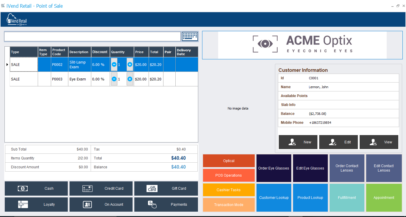

8. On clicking [Charge Services], the selected services will load to the POS transaction screen as Sale type items.
9. Click on [Order Eye Glasses] and/or [Order Contact Lens] to open the Order Eye Glasses or Order Contact Lens screen and then qualify the eye glasses and/or contact lens as required.
10. On the Order Glasses or Order Contact Lens screen, click the button, [Create Order] to load the qualified glasses or contact lens to the POS transaction screen as Order type items.
11. Now proceed further with the taking the payment and placing the order to complete the transaction.
