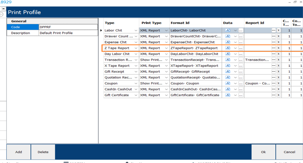

1.      Check the Print profile setting in MC :

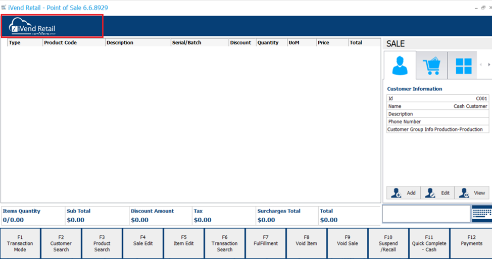

2. Click on iVend Logo on POS Screen:

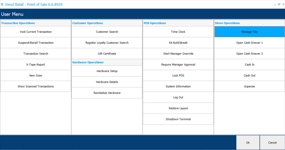

3. Then Click on Manage Till

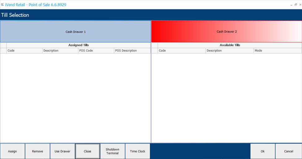

4. Click on Remove till and then Close the Till
5. Once you click on the Close till, then Z-tape will be automatically generated and receipt will come on Simulated printer.
