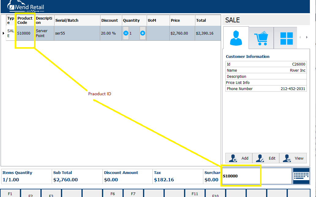

1. Use product id in scan area over the point of sale and complete the transaction
Product ID will show in field ' ScannedBarcode ' over the table 'TrxTransactionSaleItem

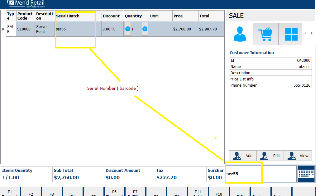

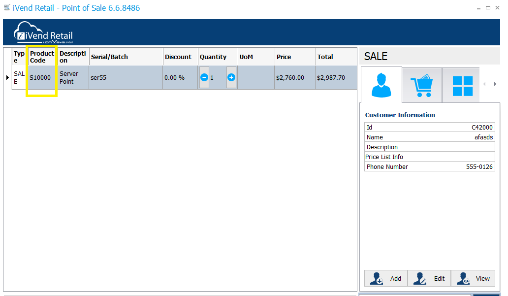

 2. Use barcode in scan area over the point of sale and complete the transaction
Barcode will show in field ' ScannedBarcode ' over the table 'TrxTransactionSaleItem

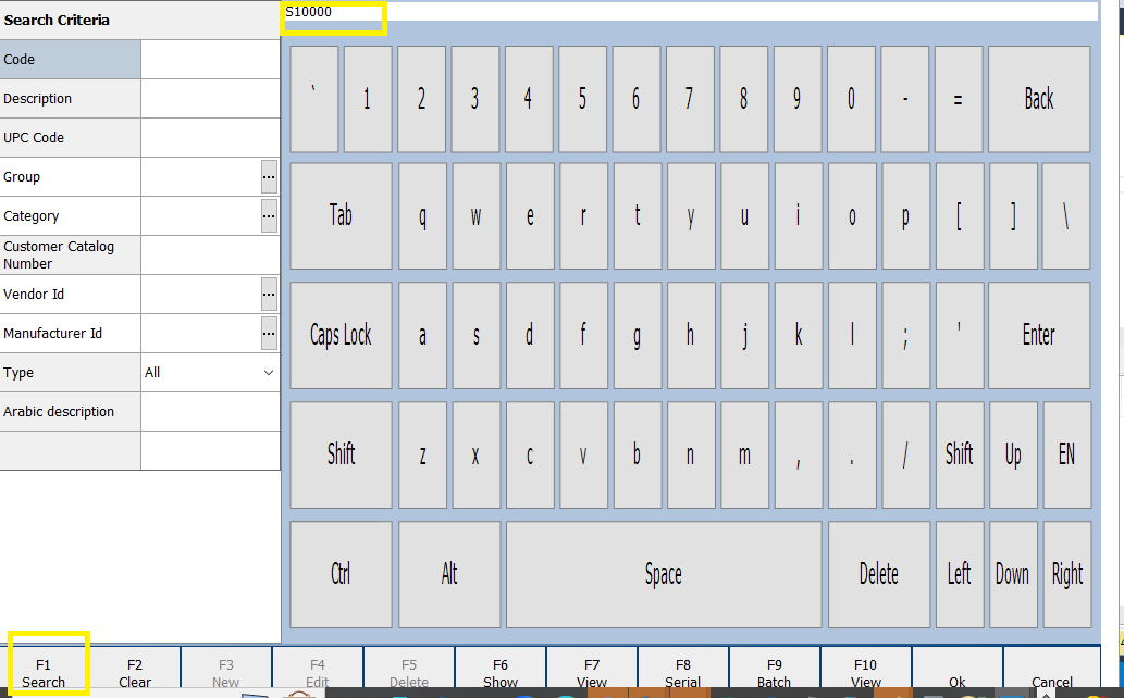

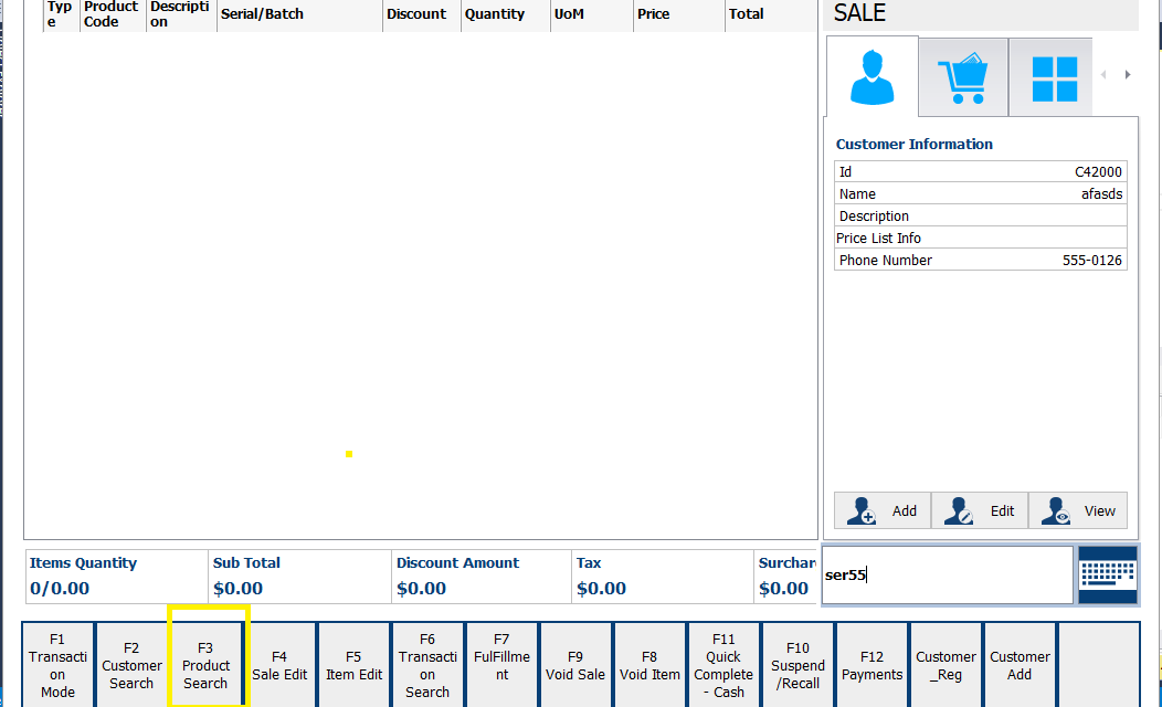

3.Search product through search button and complete the transaction
 ' ScannedBarcode ' field is showing  blank over in table 'TrxTransactionSaleItem.
