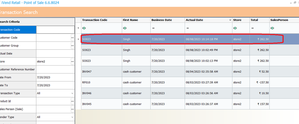

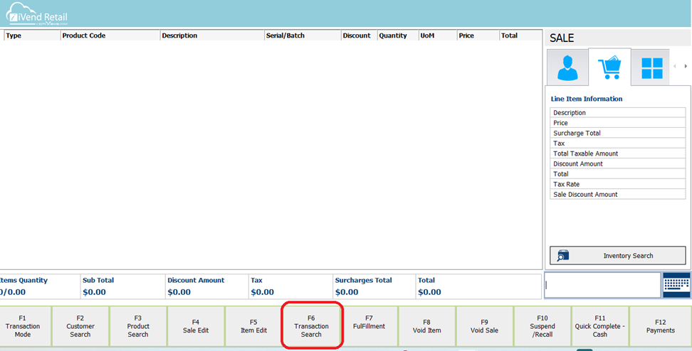

>>Click on the transaction search button on iVend POS.
>> Select special order.

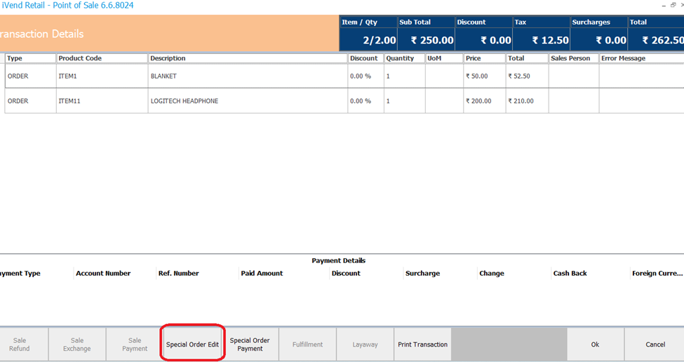

>> Click on the Special Order Edit button.

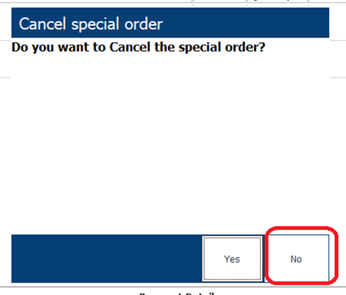

>> Then press “No” on the Pop-up window and then the special order opens in edit mode.

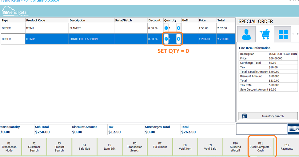

 >> Select the item you want to remove and Set the quantity 0.
Note: Void item button will not work in the Special order edit screen.

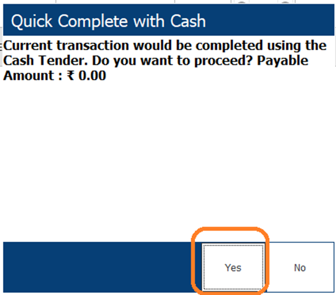

>> Then save the special order.
