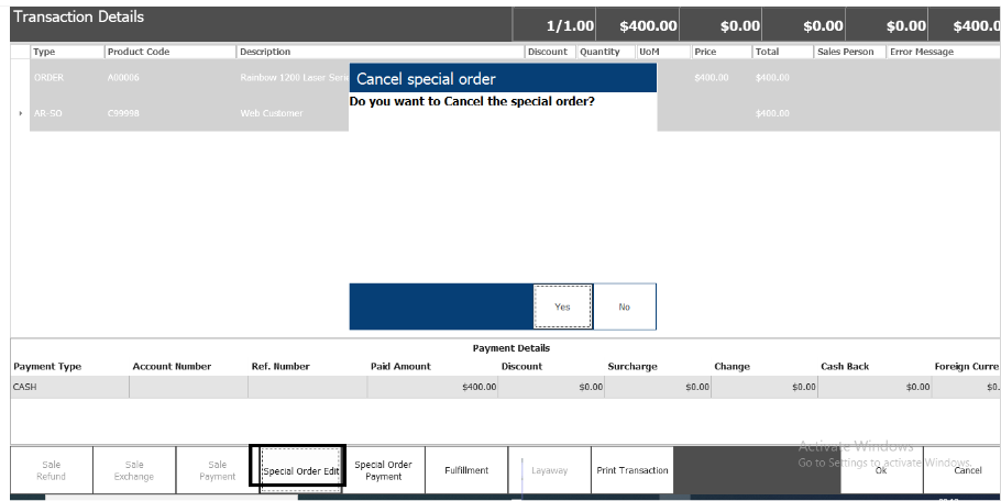

Below are the steps for cancel special order from iVend.
1: Click on Transaction Search button on POS
2: Select  special order, then click on "Special Order Edit"
System gives you pop-up "Do you want to Cancel the  Special Order?"  Click on button Yes.
