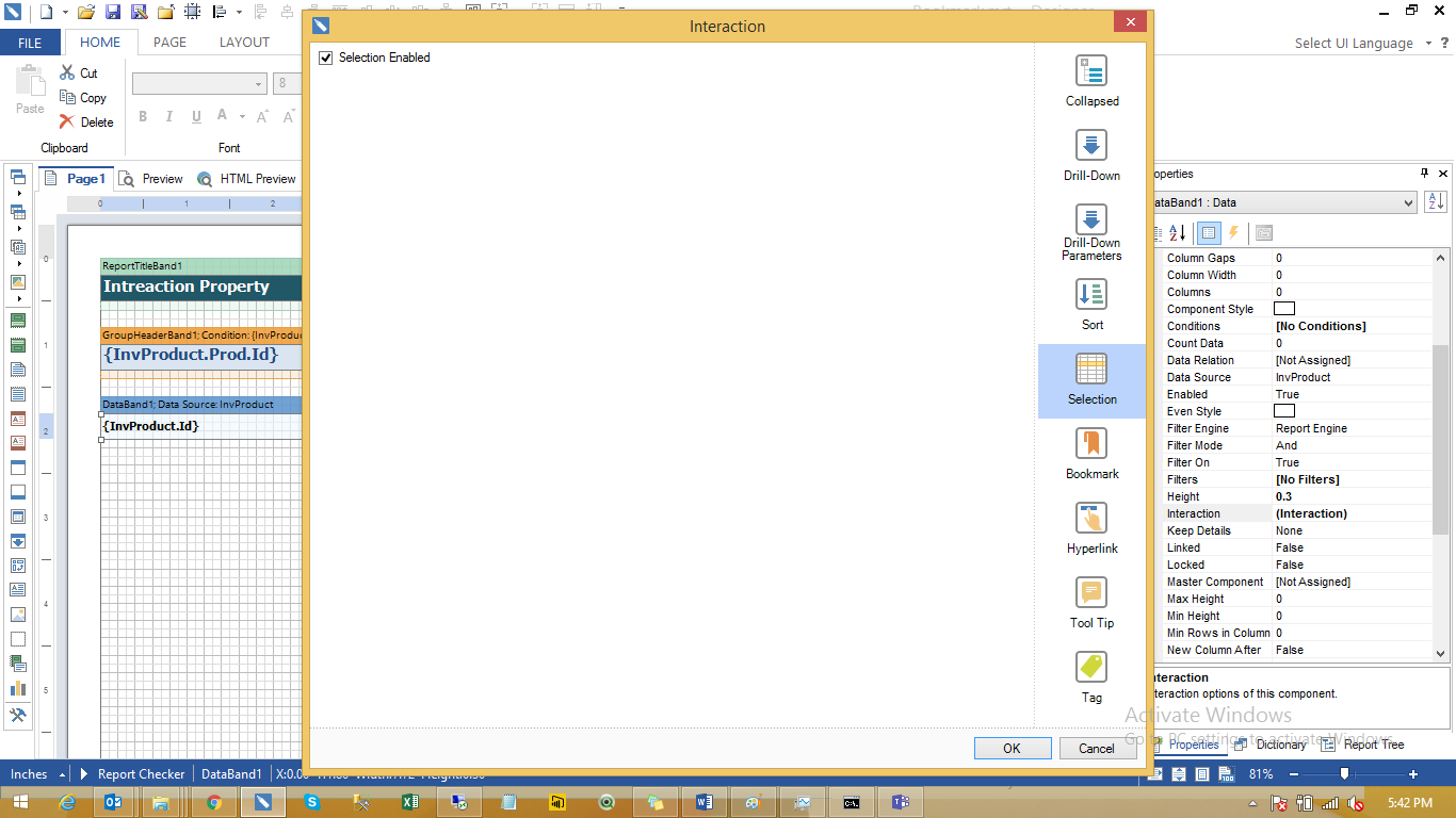

If report have multiple lines then user have face problem to point the selected line. If reporting tool have option to point the selection that is very good way to highlight the selected line.
To use Mouse over and then select the selection line using the below steps:
  1. Open a new report and create a data-source,
  2. Create the report as per your requirement.
  3. Select the Detail Band > Go to property panel > select Interaction Property
  4. The interaction window > Select Selection from right panel > Check on Selection Enable>         Click OK.

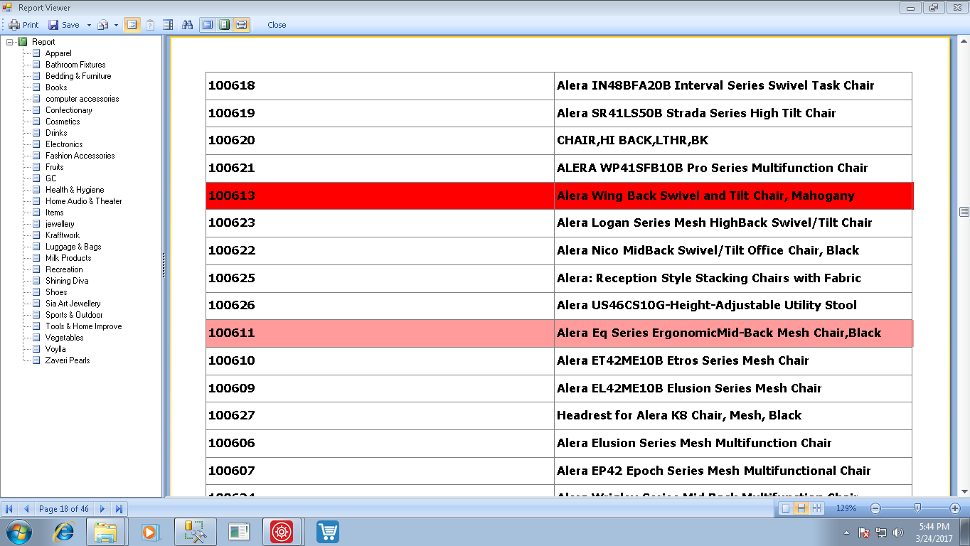

  1. Now see the preview, the Selection line on Mouse Over property is showing.
  2. Select the specific line the line selection showing as show in the Image 2
