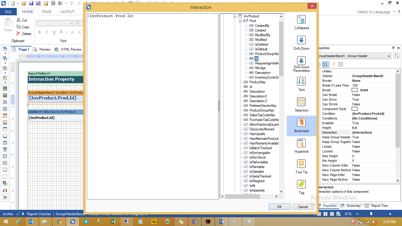

  3. Select the Group band > Go to property panel > select Interaction Property
  4. The interaction window > Bookmark from right panel > put the reference column which you want to make as Bookmark from Group relation table in Left panel. (See Image 1).
  1. Click Ok and come out from the Interaction Property.

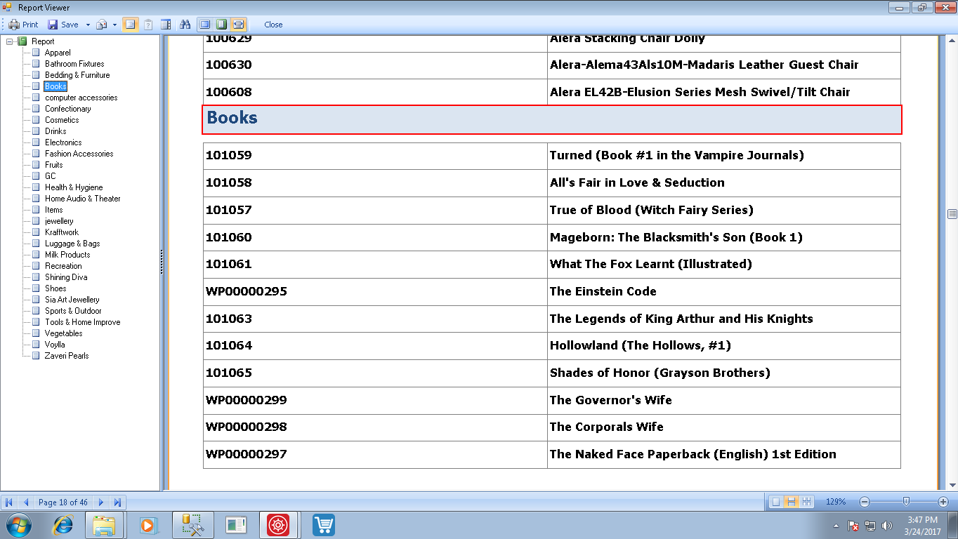

  2. Now see the preview the Panel from Left side will be display as Tree format.
  3. Click on the any node, and report will redirect on the selected group data. (See Image 2)
