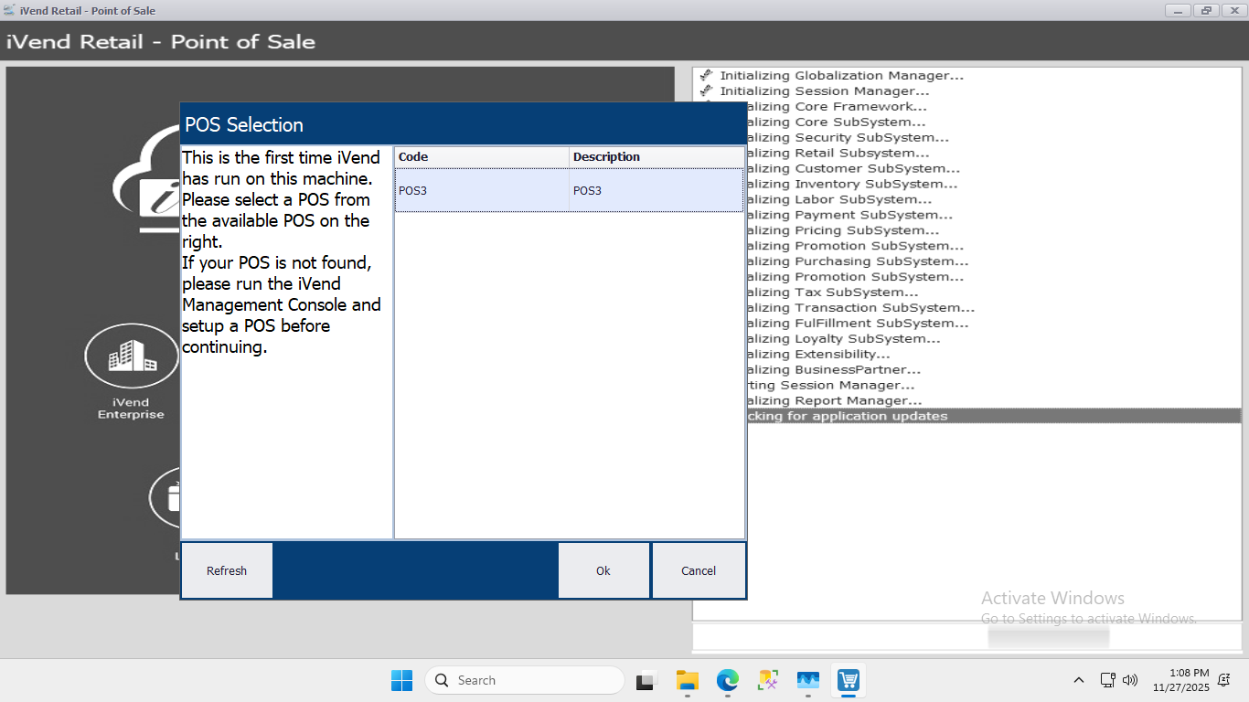

3. POS Installation and Configuration
  • Install only the POS component on the target machine.

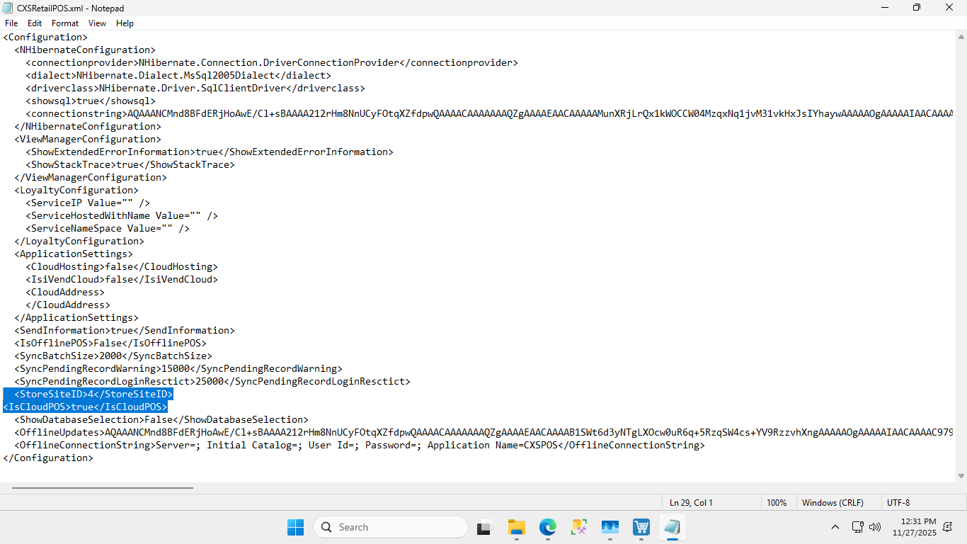

  • Update the CXSRetailPOS.xml file with the following tags:
Set IsCloudPOS to true:
<IsCloudPOS>true</IsCloudPOS>
Specify the Comingle Store Site ID:
<StoreSiteID>XXX</StoreSiteID>

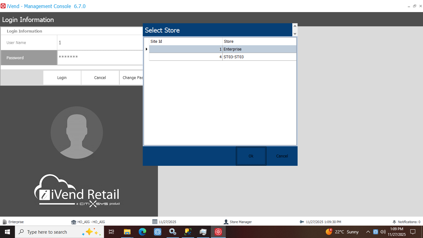

4. Connection Manager Configuration
  • Provide the Head Office (HO) machine details in the Connection Manager at Online POS machine.
  • Once configured, the HO Management Console will display all available stores for login.
5. POS Login
  • The Online POS can now be launched and logged in from a separate machine using the configured Comingle mode.
