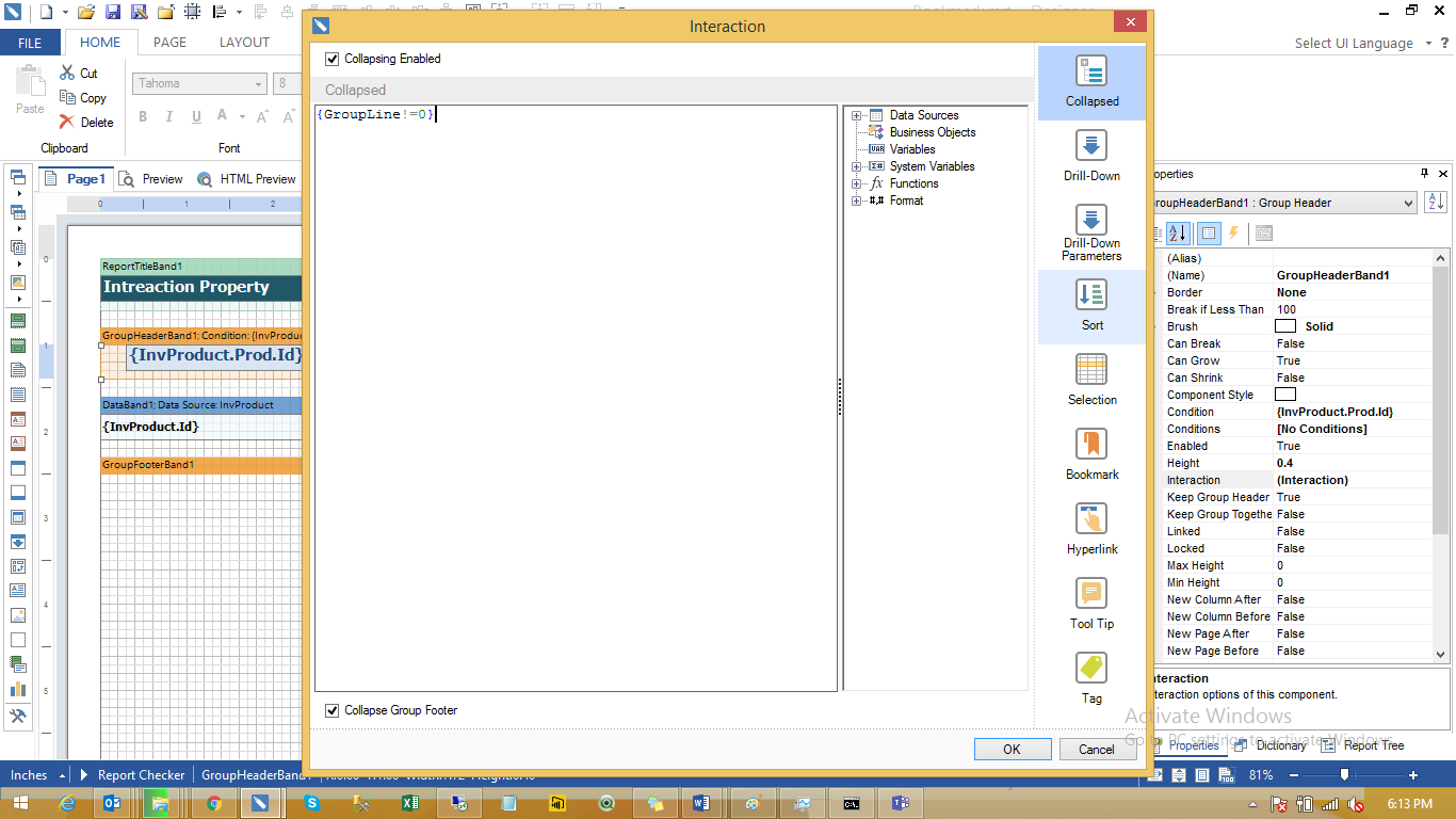

  1. Select the Group band > Go to property panel > select Interaction Property
  1. The interaction window > Select Collapsed from right panel > put the formula using same format {GroupLine!=0} for all groups comes with + sign as Collapsed mode, {GroupLine!=1} to display first group with – sign and it will comes with Expand mode, and then select the check-box on Collapsed Enabled and select the check-box on Collapsed Group Footer . (See Image 1).

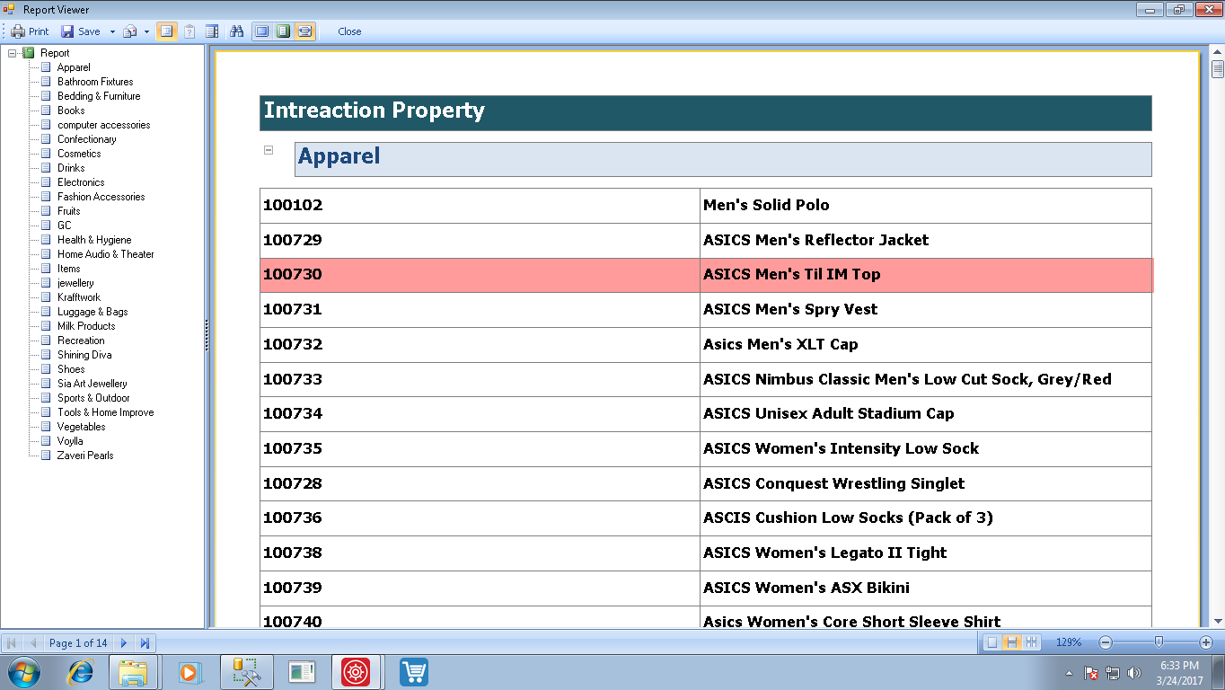

  1. Now see the preview, like in Image 2. The group display with all Collapsed mode.

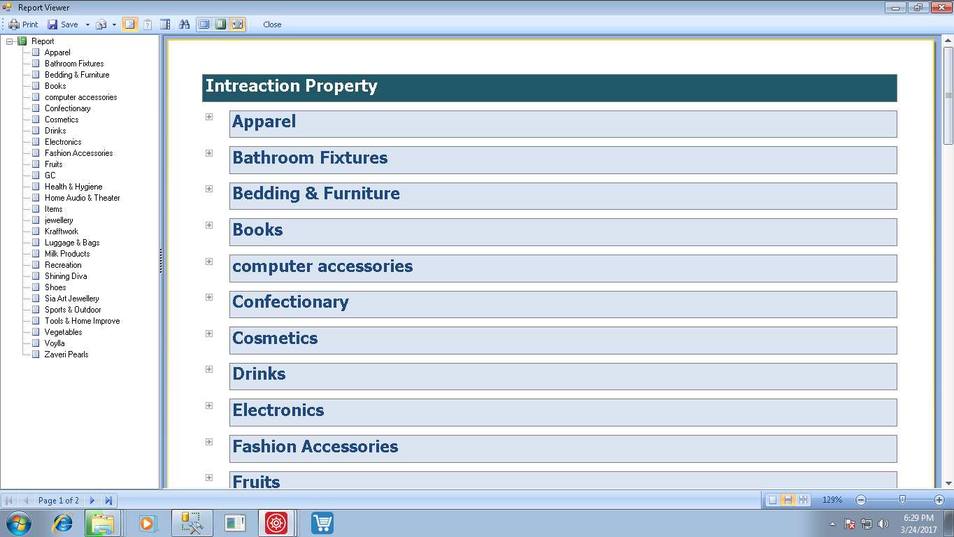

  1. Now see the preview, like in Image 3. The first group display with all Expand mode and remaining with Collapsed mode
