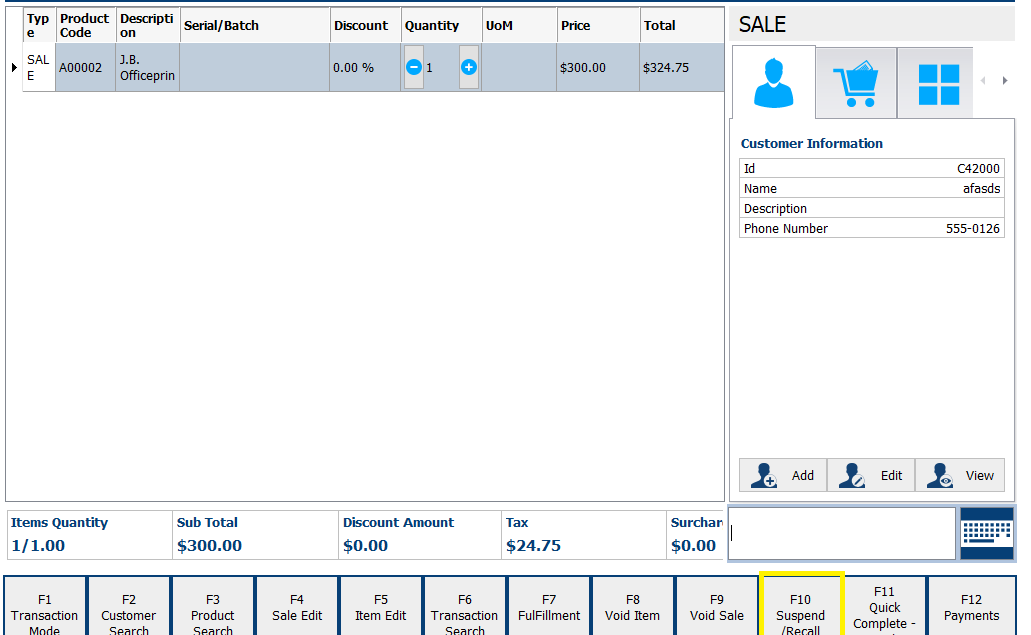

How can we enable the print suspend transaction through pos machine
Customer query

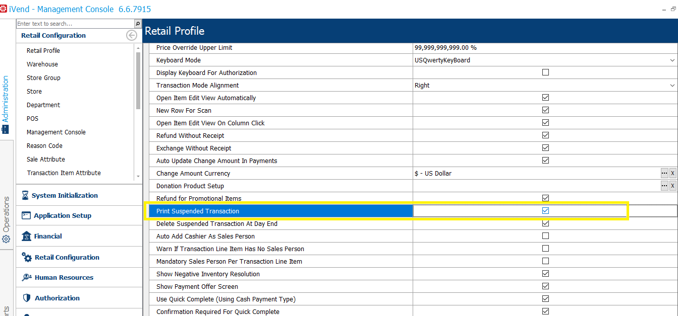

Need to follow the below steps for enable the "print suspend transaction"
1 - Open the Management console  -- >  Retail Configuration -- > Retail Profile
2. Check the "print suspend transaction"  check box.
3. After enable this option when customer can print the suspend transition through  point of sale.
