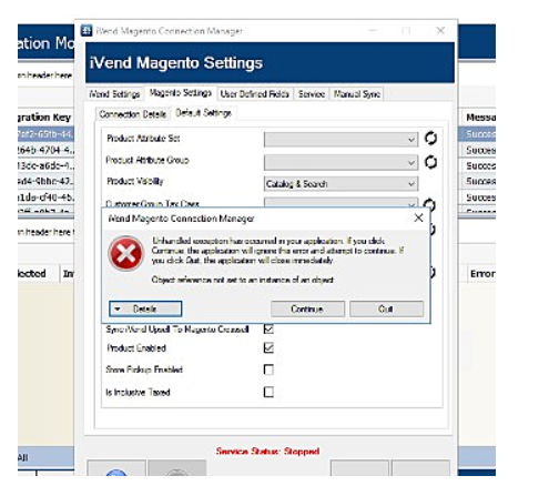

Getting an error message when setting up magneto setting.
Getting an below error message when setting up magneto setting.
Proposed Solution:-

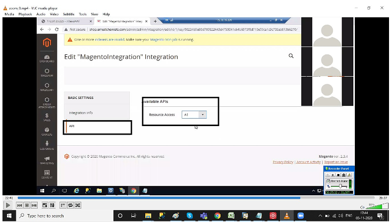

Used the reauthorize functionality functionality and change the resource type full (refer below screenshot))

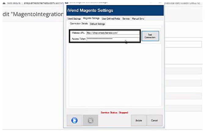

And again copy the access token to the magneto setting screen
