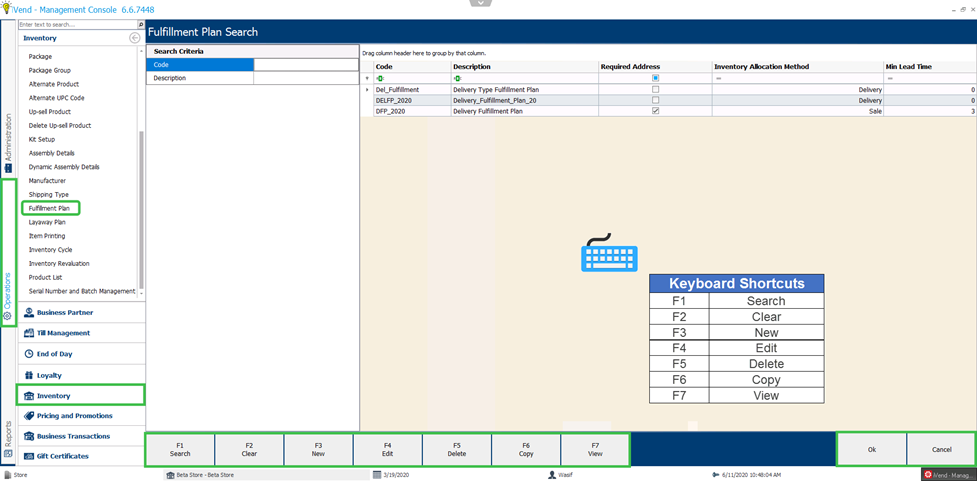

Step 1. Log into the iVend Management Console and navigate to: Operations > Inventory > Fulfillment Plan – the Fulfillment Plan Search screen comes up.
Figure 1 – Fulfillment Search Screen

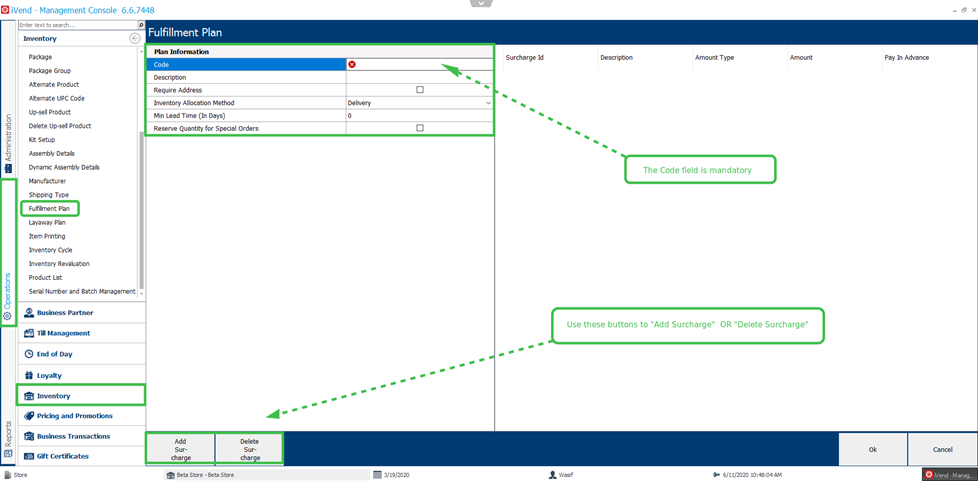

Step 2. To define a new fulfillment Plan, click on the [F3 New] button.
Figure 2 – Fulfillment Plan Setup Screen

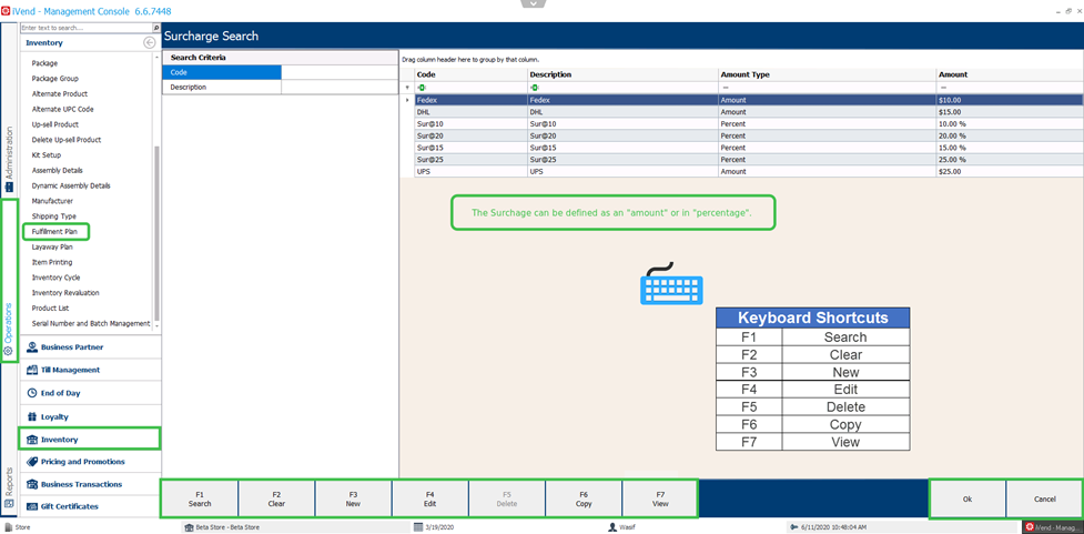

Note: When the user clicks on “Add Surcharge” he/she is presented with a Surcharge Search screen from where an existing Surcharge can be applied or a new Surcharge can be defined.
Figure 3 – Surcharge Search Screen
The table below represents the field details for the Fulfillment Plan screen:
Field
Description
Code
Enter the code for the fulfillment plan.
Description
Enter the description for the fulfillment plan.
Require Address
Check this option if the address of the customer is mandatory when the plan is attached to a Sale or Special Order transaction. This will be required to deliver the goods to the customer’s address as opposed to in-store pickup.
Inventory Allocation Method
Select one of the methods to allocate inventory:
•Sale - The inventory status of the product is updated immediately. A fulfillment plan with this inventory allocation method can be attached only to Sales and Layaway transactions.
•Delivery - The inventory status of the product is updated only after the order is delivered to the customer. This option is selected by default. This method is mandatory and is the only option when the transaction is a Special Order. This type of inventory allocation in the fulfillment plan can be used for Layaway transactions as well.
Min Lead Time
Enter the minimum time required to deliver the order. The default value is 0.
Subsidiary
Select a Subsidiary to which the fulfillment plan belongs.
Note:- This is field is visible only if the Subsidiary function has been enabled in the system.

[Add Surcharge]
This button enables the user to add a surcharge by selecting a surcharge from the list of available surcharges. Click the button to open the Surcharge Search screen and select the surcharge. To add a new surcharge, press the [F3 New] button in the Surcharge Search screen.

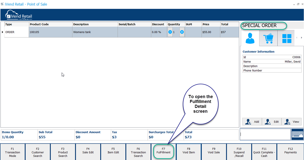

For a transaction at the POS, the user can add a Fulfillment Plan after selecting the customer and the products. The Fulfillment Details screen will be displayed on pressing the [F7 Fulfillment] button on the main POS transaction screen. This screen enables the user to add a plan to the transaction.

Step 1. Click on the [F1 Transaction Mode] button to select the type of the transaction that requires a Fulfillment Plan such as a Special Order or Layaway transaction. Note: Transaction modes of Special Order and Layaway require that a registered customer be selected first - Click the [F2 Customer Search] button to open the “Customer Search” screen and select the customer. The user can also enter the code of the customer in the scan area to quickly add the customer to the transaction.
Step 2. Click the [F3 Product Search] button to open the “Product Search” screen and select the products to be added to the transaction. The User can also use the barcode scanner or enter the product code in the scan area to add products to the transaction.
Figure 4 – Point Of Sale Screen

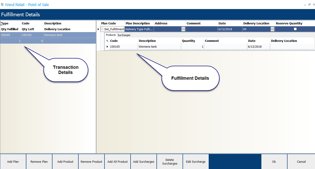

Step 3. Click the [F7 Fulfillment] button to open the “Fulfillment Details” Screen and here the user can update the quantities.
Figure 4 – Fulfillment Details Screen
Step 4. Clicking the ‘Reserve Quantity’ field (top right corner) will mark the inventory as ‘On Fulfillment’. This status will change only when the items are successfully delivered.
Step 5. After adding the required information, the user can click the [Ok] button to save the changes made and to go back to the main transaction screen.
