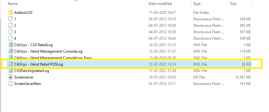

It has been seen that it is the log file that contributes towards slowness during printing, so a preliminary action can follow the below steps.
1. Goto the below path on POS to the Log file;
C:\Users\localhost\AppData\Local\CitiXsys\CXS.Retail\CitiXsys - iVend Retail POSLog.xml
2.Delete the POS log file.
3.Relogin to the POS Application and check the performance
