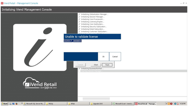

Facing following error while login to MC and not able to login to MC: Unable to validate the license, below is the screenshot for the same:
Shows the error message “unable to validate license” when trying to launch MC and not able to login to MC.
