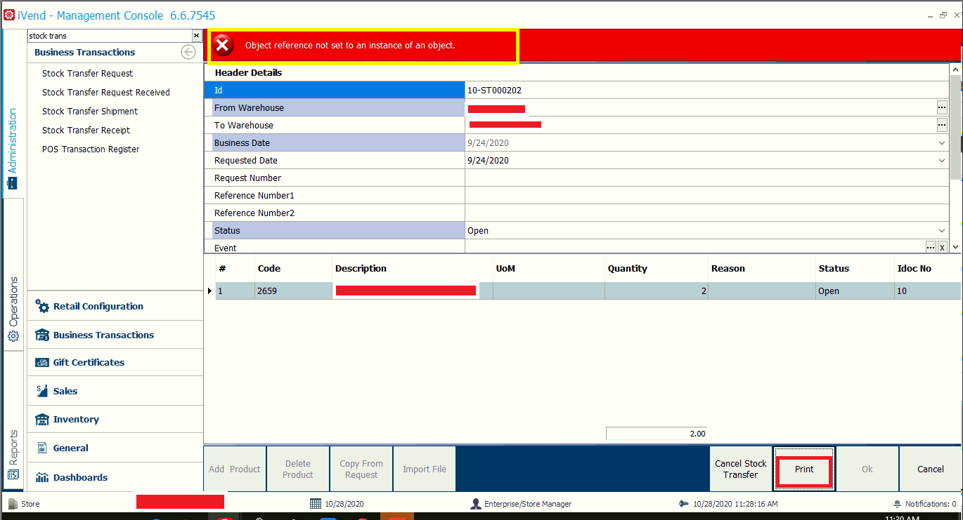

Stock transfer receipt can not be printed from the Management Console
Getting the error
“Object reference not set to an instance of an object” while printing the stock transfer receipt as shown below:

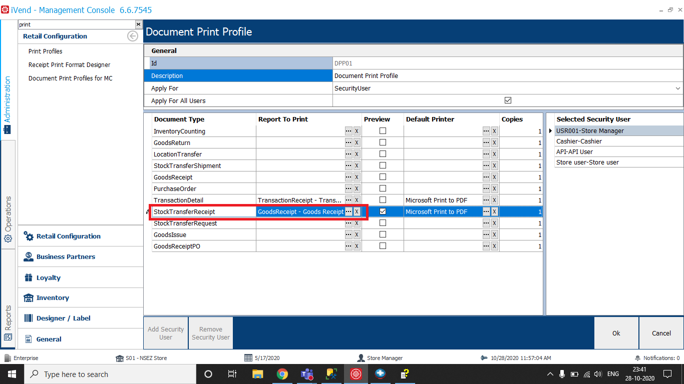

Cause:
Possible cause of the issue is that the correct report is not mapped with the document print profile
To resolve this change the “Report to print” to “Good Receipt” for stock transfer receipt as shown below:
