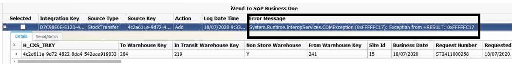

ERP Integration Stock transfer stucked System.Runtime.InteropServices.COMException (0xFFFFFC17)
Product Version
6.6 integrated with Sap B1
Stock transfer stucked on Integration Failure Monitor from iVend to SAP with error message “System.Runtime.InteropServices.COMException (0xFFFFFC17): Exception from HRESULT: 0xFFFFFC17’
Proposed Solution
Require to remove space in the comment field through sql query.
Steps
Below are the steps which we require to follow for analysis issue.
Require to check comments field data on Table Invstocktransfer. If there is too much space in the comment field then we require to remove space.
