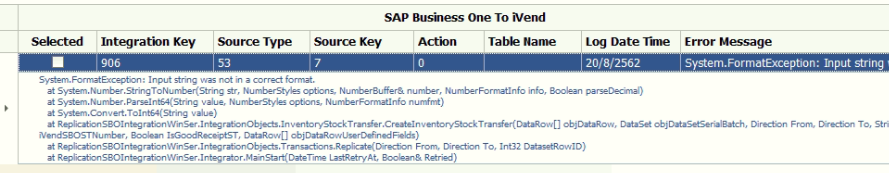

Record stuck on Integration Failure Monitor with error message from SAP to iVend.
System.FormatException: Input string was not in the correct format.
at System.Number.StringToNumber(String str, NumberStyles options, NumberBuffer& number, NumberFormatInfo info, Boolean parseDecimal)
at System.Number.ParseInt64(String value, NumberStyles options, NumberFormatInfo numfmt)
 at System.Convert.ToInt64(String value) at ReplicationSBOIntegrationWinSer.IntegrationObjects.InventoryStockTransfer.CreateInventoryStockTransfer(DataRow[] objDataRow, DataSet objDataSetSerialBatch, Direction From, Direction To, String iVendSBOSTNumber, Boolean IsGoodReceiptST, DataRow[] objDataRowUserDefinedFields) at ReplicationSBOIntegrationWinSer.IntegrationObjects.Transactions.Replicate(Direction From, Direction To, Int32 DatasetRowID) at ReplicationSBOIntegrationWinSer.Integrator.MainStart(DateTime LastRetryAt, Boolean& Retried)
Proposed Solution:
Log Date Time is incorrect which seems causing the issue Log Date time ie. 20/8/2562:Suggested to check the date of Stock Transfer in SAP and compare it with iVend Transnational data
