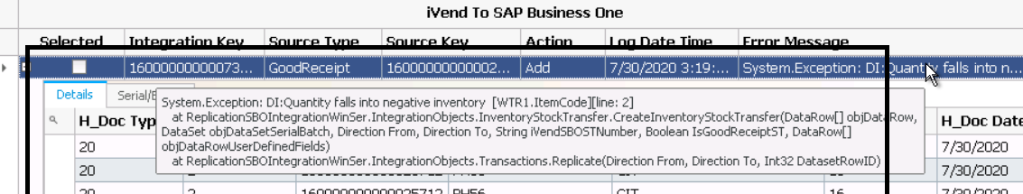

Good receipt add stucked on Integration Failure Monitor with error message
“System.Exception:DI:Quantity falls into negative inventory [WTR1.ItemCode][line: 2]”
Proposed Solution
Suggested to check item quantity or serial/batch is available in SAPB1 Intransit warehouse or not.
It is Good Receipt based on Stock Transfer shipment document so require stock on SAPB1 in-transit warehouse.
