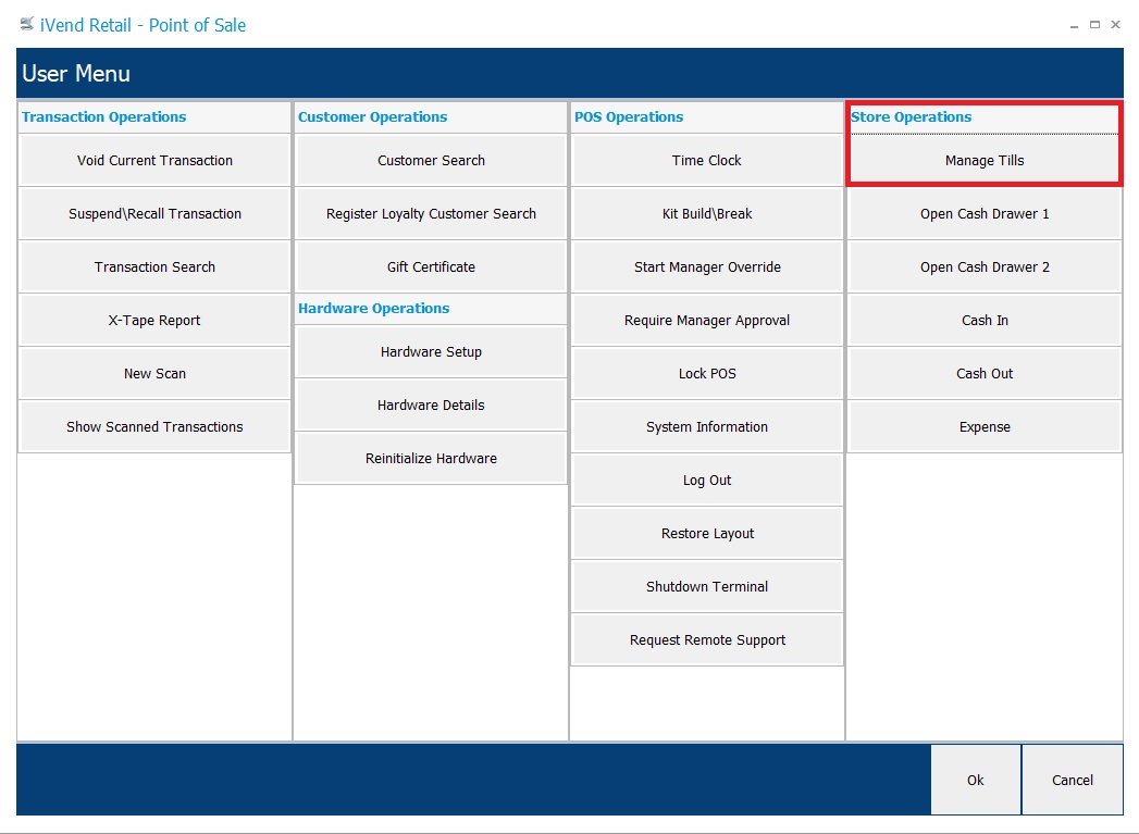

6. At the End of Day, the cashier can navigate to the iVend Retail POS User Menu and select the option Manage Tills under Store Operations.
7. The Till Selection window appears.

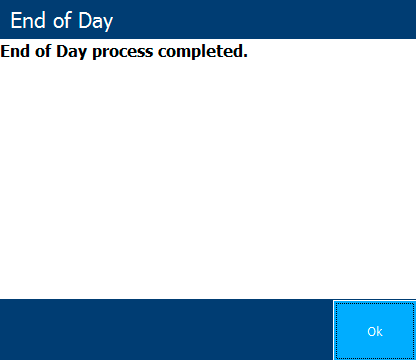

11. The End of Day window appears – The cashier can then select the next Business Date from the drop down.
12. The Shutdown of the application window will appear and the cashier can select the [Ok] button to confirm and the POS application will close.
13. The Store and POS have now moved to next Business date.

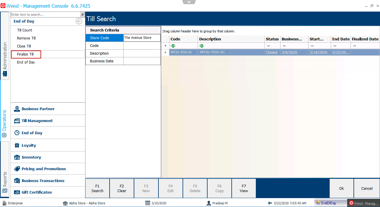

14. Later, the Store Manager can access the Management Console and Finalize the Tills at his or her convenience. Finalization of Till is performed after the End of Day process is run. Finalization should be completed before commencing trade of the next Business day.
