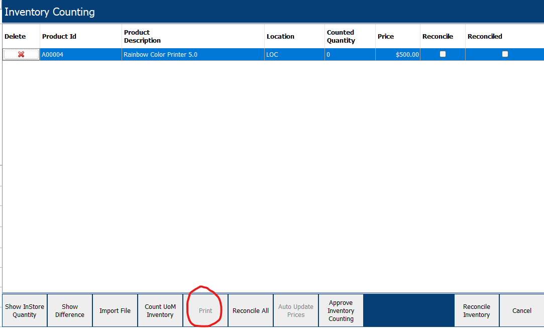

Enable the Print button on Inventory Counting
1: Login in MC.
2: Click on Administration Tab >> Retail Configuration >> Document Print Profile.
3: Select Document Print Profile and click on Add/Edit.
4: Map the “Report in Report To Print Column” and click on OK button, check below.
Then Restart the Management console
Then the Print button will Enable on the Inventory Counting Screen, check below
Click on the Print button to check
Click on Adobe PDF file to export the data.
