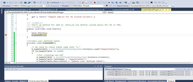

Press the F9 key or on the DEBUG menu, click Toggle Breakpoint to create a breakpoint. The red circle appears at the start of the code line after creating a breakpoint.
1. Open the iVend Retail Add-on project.
2. Identify the code section that has the possibility of an error.
3. Create a breakpoint.

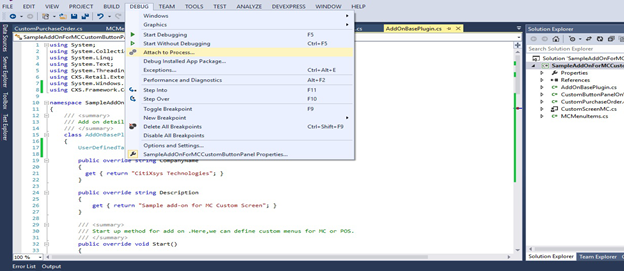

1. On the DEBUG menu, click Attach to Process…

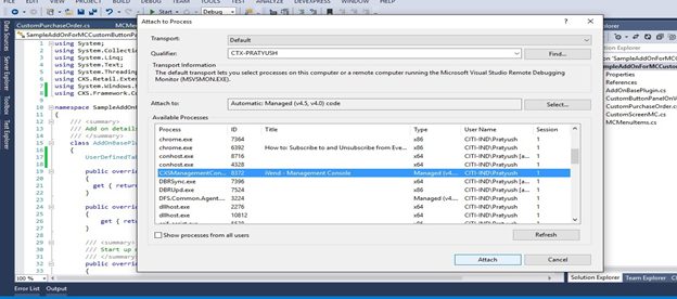

2. Select a process from the Available Process section in the Attach to Process dialog box.
3. Click the [Attach] button.

Figure 1 Attach toProcess
Figure 2 Select from Available Process
Figure 3 Add On Base Plugin
