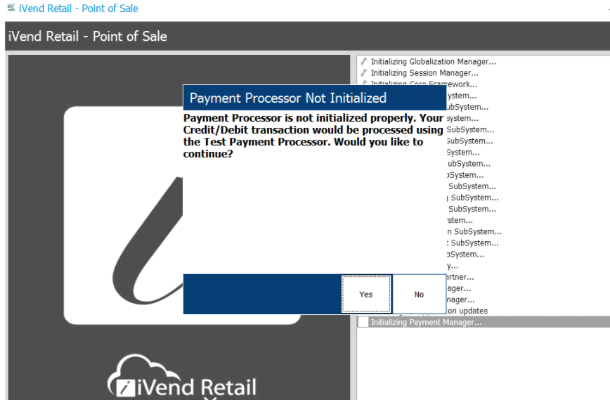

A Common Error Message that can be Returned during the POS Start up
If there is any error with the Datacap configuration or any other setting related to it, the POS will usually show an error during the start up at the POS, as shown in the below screen image.
The error information will be logged into the POS log file (Generally, located in the following path with the standard installation of iVend Retail, where the value [Local User] needs to be replaced with the actual logged in user:
C:\Users\[Local User]\AppData\Local\CitiXsys\CXS.Retail)
1. dsiEMVUS is not installed:
In case dsiEMVUS is not installed on the POS machine an error similar to the one shown below will be captured in the POS log file.
<Message>Retrieving the COM class factory for component with CLSID {F17CF553-1802-4450-92E1-469A0544FD63} failed due to the following error: 80040154 Class not registered (Exception from HRESULT: 0x80040154 (REGDB_E_CLASSNOTREG)).</Message>
2. Payment Processor Unique Identifier is Blank
If the Payment Processor Unique Identifier is not setup on the POS Master from the iVend Management Console then the POS will show an error during start up that will indicate this
