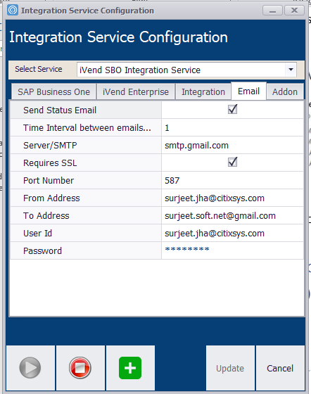

1). Go in Configuration Manager and launch Integration Service configuration window and fill all the required details in the EMAIL tab as per below Screen.
In the filed “Time Interval between emails(hours)” value entered is the hour difference to trigger the Email.
