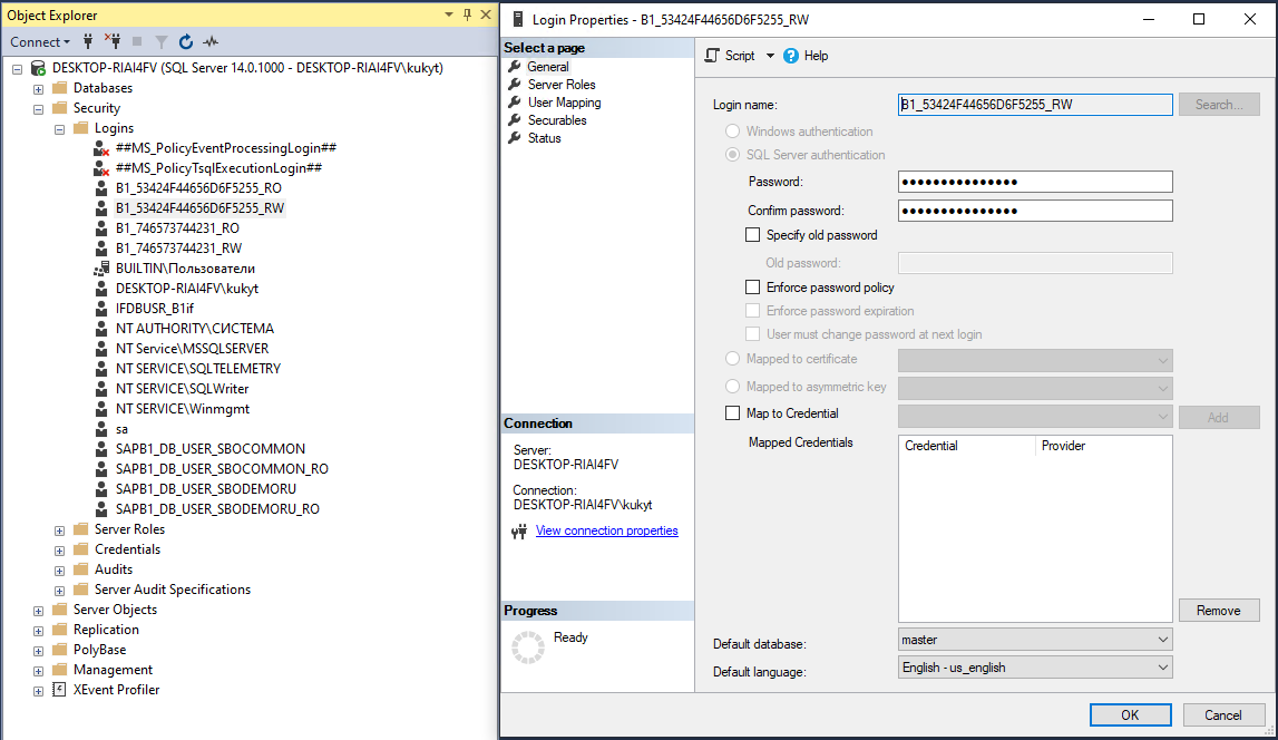

1. Login in your System Landscape Directory, and check "Database User" for the Database in which iVend add-on is installed.
2: Login in SQL Server with user ID SA.
Go to: Security>> Logins>> Right click on SAP Database User >>> Properties.

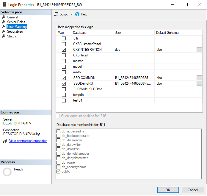

3: On the Login Properties window click on “User Mapping” Below window will appear.
Check the check box for “CXSINTEGRATION” and click on OK button.
4: Exit from SAP Business One and then Login and try to connect iVend add-on
