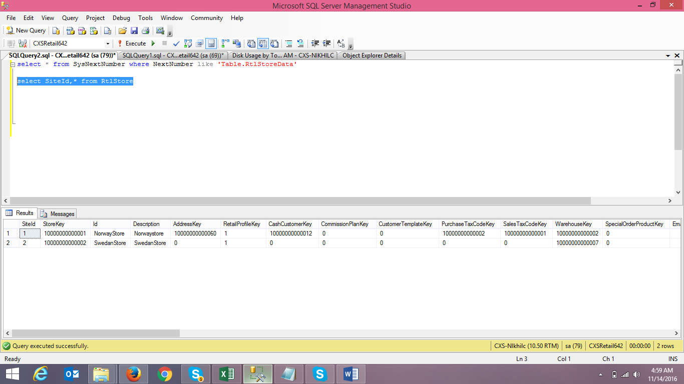

3.iVend table RtlStore contains site id information of Store
select SiteId,* from RtlStore
4.iVend table SysNextNumber contain the next number of site id of store
select * from SysNextNumber where NextNumberid like  'Table.Store'
5.So to change it as separate store, you need to check what is last site id number in SysNextNumber for NextNumberid like  'Table.Store'  and then assign this number on RtlStore table for particular store key and Site id using SQL Query window :-
update RtlStore set SiteId='Put Next Site id' where StoreKey='Put Store key' and SiteId=1
