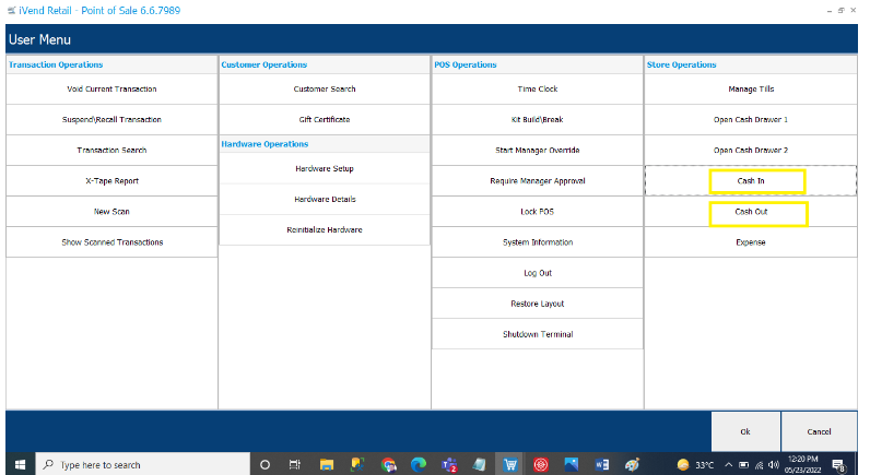

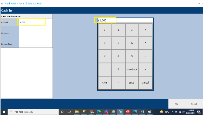

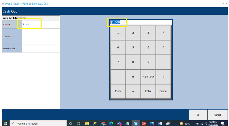

The user can do Cash In/Cash Out for the till at the POS. Cash In is done if the till is out of change or to add some standing amount to the till. Cash Out is done if the till reaches a tipple point or some amount is needed at some other till in the store.
From Pos Application user can perform the activity from below steps: -
Cash In or Cash Out as needed is clicked on the User Menu screen to open the "Cash In/Out" Screen and perform the required activity.
