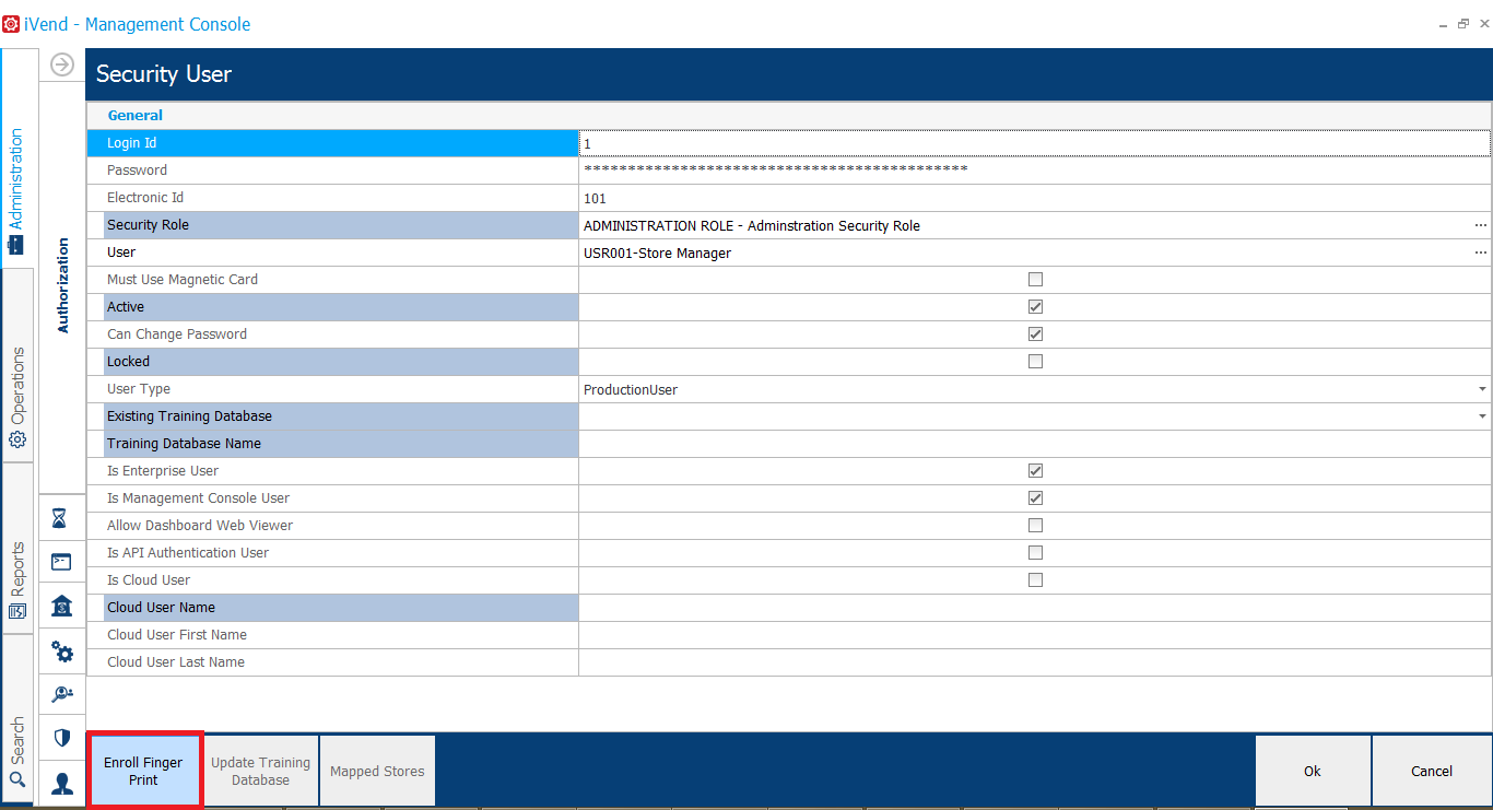

With the release of iVend Retail POS, version 6.4.1 and above, biometric authentication is very much possible. The “Enrol Fingerprint” feature allows the administrator or user to enrol and/or delete fingerprints from the system.
To open the window, choose Administration >> Authorization >> Security User >>  [Enrol Finger Print]

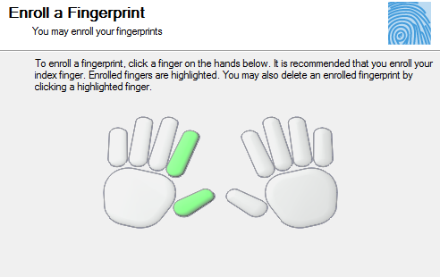

2. The "Finger Scanner" screen will appear as shown in Figure .

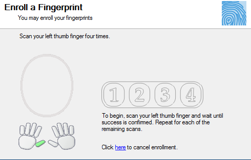

1. Select a finger on the screen, and the screen as per Figure  will appear.

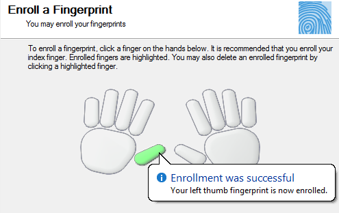

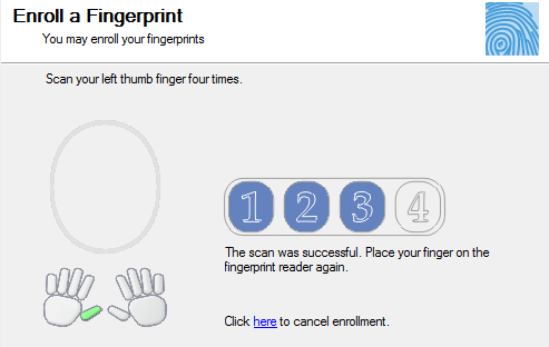

1. Press your finger against the sensor to enroll your fingerprint 4 times until the fingertip is recognized and accepted. After each successful scan, a screen will appear as shown in Figure .
1. After successful enrolment, the screen as per Figure  will appear.

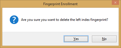

1. The "Finger Scanner" screen will appear as shown in Figure
1. Click the finger for which the fingerprint data needs to be deleted. A pop-up will appear as shown in Figure
1. Click Yes. A confirmation message will appear for fingerprint deletion as shown in Figure
