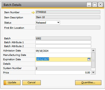

As an example, if the Expiration date/ Admission date is updated for any batch item in SAP, then this updated information does not reflect in iVend.

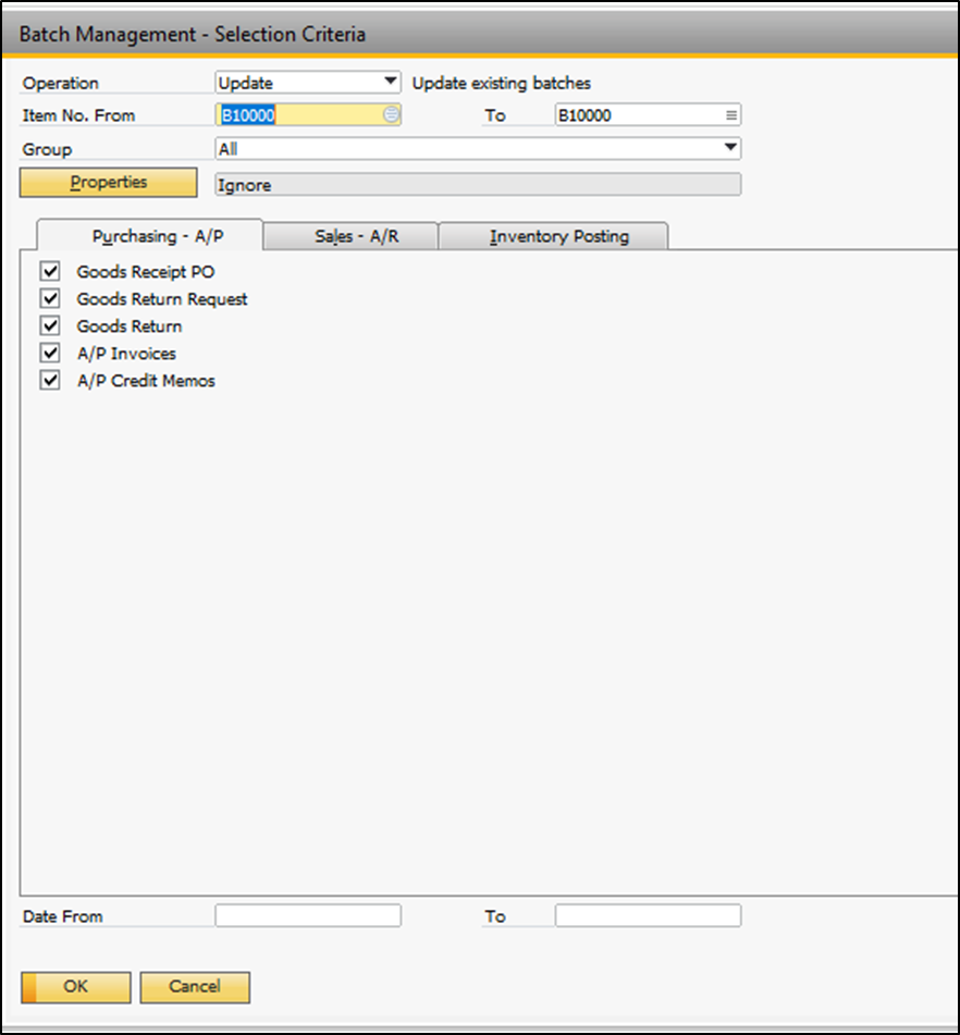

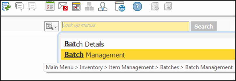

1. Open "Batch Management" in SAP.

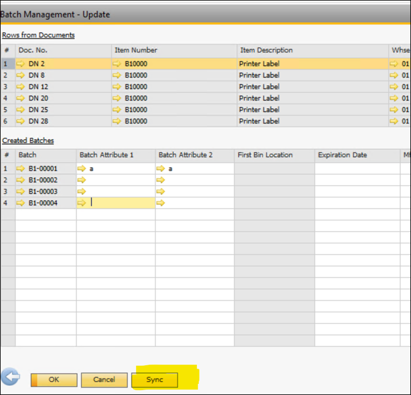

2. Fill in Item No. From and To fields and click on OK button. 3. After clicking 'OK', the Batch Management update window will open. Then, select the batch and click the on “sync” button.
